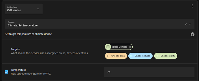

You’re looking at the wrong place. :slight_smile:
Device means in this situation, you want to control a specific device, eg. a Midea unit and it’s specific functions. What you’re looking for is to control a climate entity, so you have to call services from the climateintegration.
In your case under actions use not device but service. There you’ll find the climate specific services.
I know, this is a hard to understand thing, especially with climate or fan entities.
EDIT: You might want to tell us, what it is exactly, what you want to achieve, eg. “turn on the climate unit, if someone opens the backdoor”. :wink:
Thanks for the response!
I am trying to adjust the temperature based on time. So at 7 AM the unit changes to 76F and at 8PM the unit goes to 70F.
Your explanation was great!
I had messed with call service and it didn’t work, but it was because used the Midea device not the entity Midea Climate.
Now this config works just fine!! Thank you!!

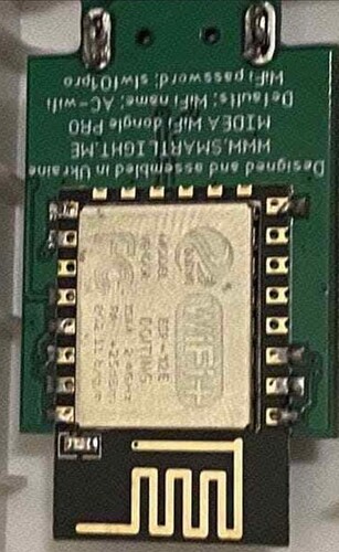

2022 midea AC - AG2ECO 09NXD0-I
Original dongle was EU-SK105
Replaced with Smartlight ESPhome dongle
Home assistant detect dongle but no communication or control of AC unit

the dongle is not receiving anything from the ac.
Tried swapping tx/rx?
Also possible gpio’s are configured wrong?
(easy to test when connecting tx to rx, you should see the same on tx and rx then)
when you say swap the TX/RX how would I do this when it’s a dongle? Do you mean at the usb header end? Can this be done via software and update via the web browser OTA?
You can select the pins in the ESPHome yaml file. :slight_smile:

I managed to speak to the seller and they gave me the config.yaml

Im guessing I need to switch 1 and 3 around at UART and then try flash it?
So I made the changes to
uart:
  tx_pin: 1
  rx_pin: 3
downloaded the firmware, flashed it OTA and now can see way more data in the web viewer. ESPhome for some reason cannot adopt the dongle though
