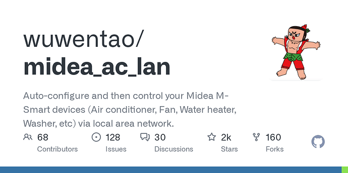

Just a quick heads up there are two Midea integrations:
  • The one built into HA
  • Midea AC LAN
I believe the built in one is being actively worked on, but it doesn’t yet have feature parity with AC LAN.
There is also a question about the token servers that Midea operate, specifically there are two unknowns:
  • If either of the integrations will be cut off remotely by Midea.
  • If you will be able to add new devices.
I am still running AC LAN (it works for me at the moment), but I haven’t been able to add any new devices and I have to have an active internet connection - HA can’t control my AC if I lose internet.
NOTE: I don’t have the specific hardware you are asking about, just providing you with some more questions to follow up on.
