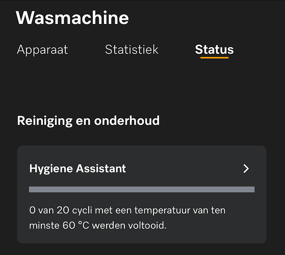

I have been using it for a few days and did a compare with the Miele App.
I noticed that on Miele App the following items are available which would be nice to have in HA.
Under Status → Reinigen en Onderhoud → Hygiene Assistant.
The Hygiene Assistant would be good to have under HA.

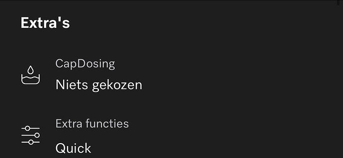

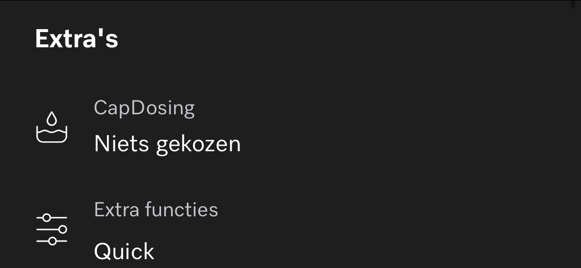

Under Apparaat (device)
There is available under Extra’s
Cap Dosing and Extra functies

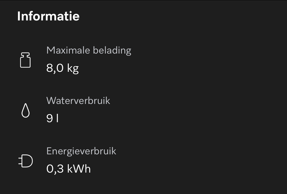

Also under Apparaat
Informatie
Maximale belading (have not seen this change during usage)
Waterverbuik (water usage)
Energieverbruik (energy usage)
Water and energy would be really nice to have so in HA we can track this like with switches etc.
