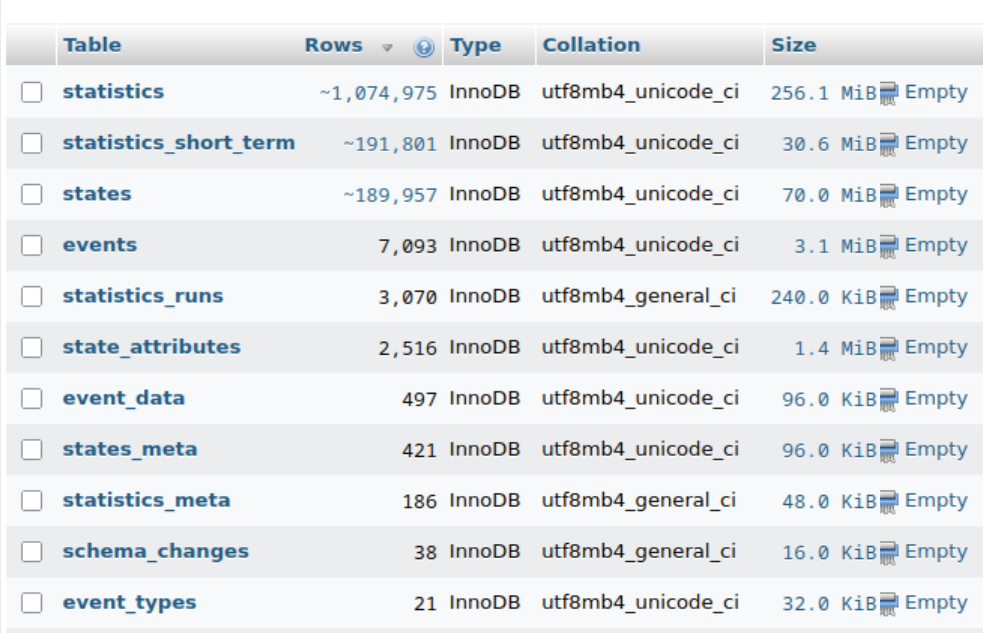

This leaves Mariadb, which is the one container that gives me pause. It looks easy enough to install Mariadb into HAOS. My question is that I have over a million rows of stats. Does it matter? Am I losing something if I don’t migrate this data? Is it possible to migrate this data? Is it worthwhile?
I’m not scared of mariadb-dump and migrating the data. I just can’t tell if this data is doing anything good for me, or if it’s just taking up space. I can leave the old database online after I create the new VM. I can migrate later. I’m in no rush to shut it down or reclaim the space. Am I going to actually make things worse for myself by migrating old data? Will it just muck up all the displays having prior history from a different system?
