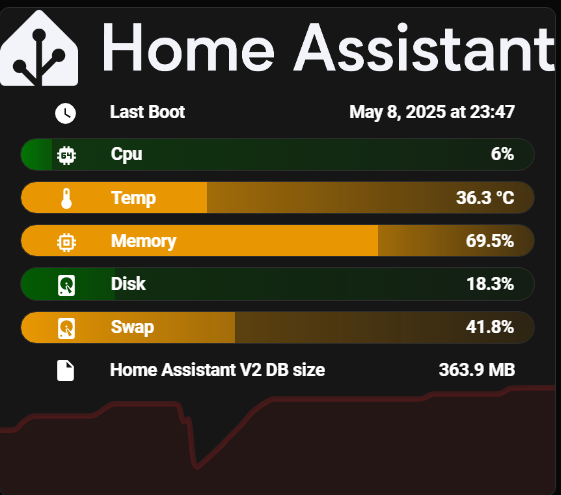

I have the same problem with high Memory load on HA Blue, and is wordering of moving Frigate out to a separate Mini PC running HA. Any idea if this will lower the HA Blue load?
My HA Blue at the Moment. Swap can run up to 80-90% at times.
Add-Ons
Still runs quite swiftly, especially after I shrunk the Database size down. I have A HP G9 Mini i5, that I will be loading HA on with Proxmox. (At some point)
