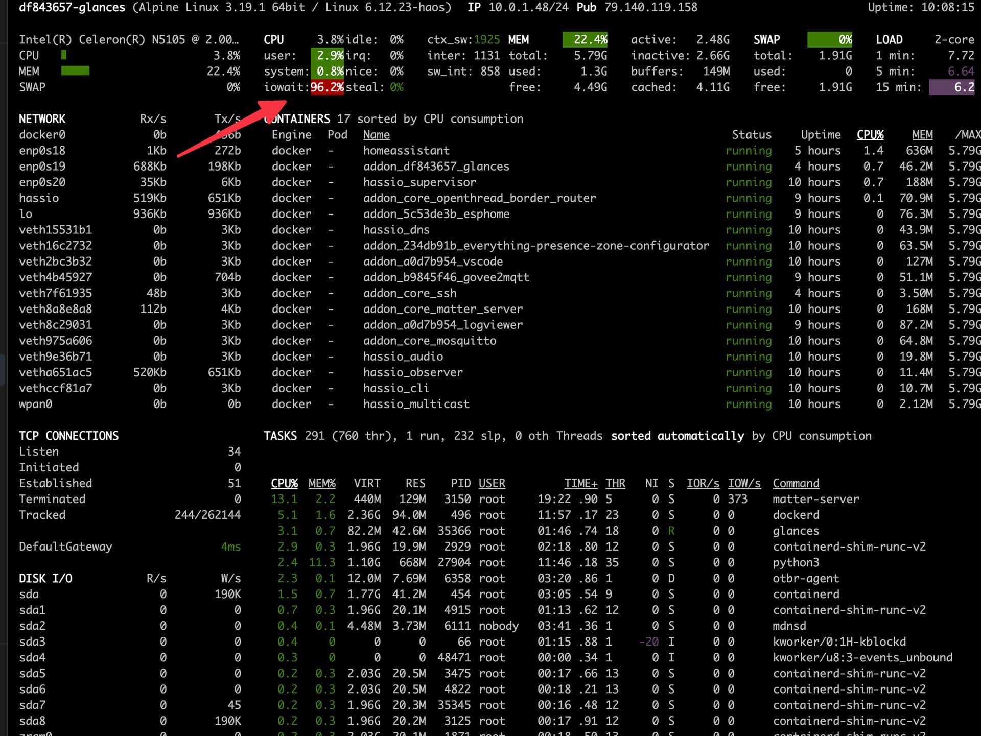

Okay so after going through another few hours of automations, I’m almost at my whits end with this HAOS installation haha. For example, a mmwave motion sensor of mine triggers two matter over thread E27 light bulbs in the hallway. One of the simplest automations you can imagine and has run perfectly on the supervised install for 9+ months now. This evening though, I’d say only about half of the time I walk by is the automation successfully run and then often it somehow only triggers one of the lights. Also the historically rock solid (for me) drigirera Ikea integration doesn’t react to 1/2 of button presses.
Anyway, enough complaining - I installed the glances addon and immediately discovered my problem:
Yup, so the proxmox community script enabled write-through caching and ssd emulation on the scsi disk for this VM. I didn’t have either of those enabled previously. Disabled them again and disk performance is back, io_wait is down to basically 0, and HA is feeling so much better!

Good question. I’m running HAOS on Proxmox installed from community script and both write-though caching and SSD emulation are enabled, but I don’t have the experience mentioned. Home Assistant performs well and installing Glances shows 0 - 0.1% iowait times. So not a universal problem or fix.

And yeah must be something weird on my system. Although its not too uncommon. I’m using one of those popular minisforums-type N5105 mini pcs where the case is made out of aluminum and is also the heat sink, and a 512gb m2 ssd directly on the board.
EDIT: basically one of these: https://www.newegg.com/p/22Z-007C-006E1. Running proxmox 8.3. Wondering if this issue rings a bell to anyone
