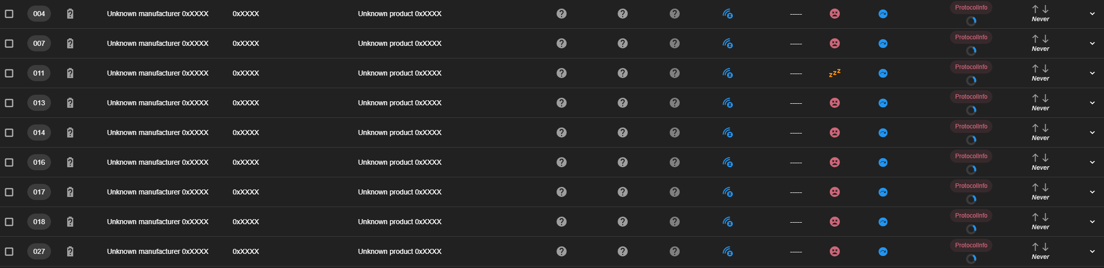

Hey there,
did anyone already manage to migrate from Z-Stick Gen 7 (FW/SDK: 7.11) to ZWA-2?
After following the instructions I end up with Zwave JS UI looking like this:
Anyone have a hint on how to successfully migrate?

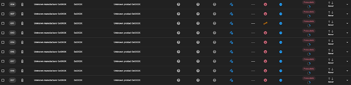

Hey there,

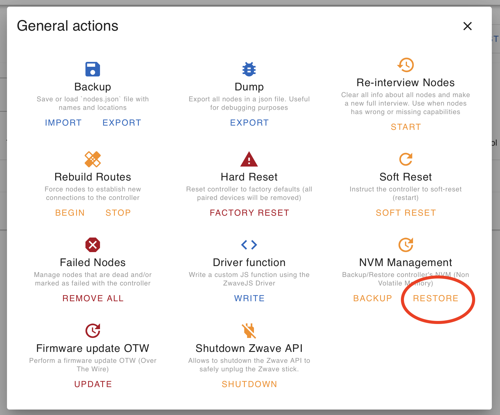

Did you perform it using the restore function in the NVM management of Z-Wave JS UI
Would restoring a system backup also work? Do you know?
I just replugged the Zstick and set the device back in the settings.
