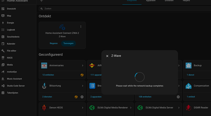

Today I received the ZWA-2 and of course happily started a migration…
About an hour ago! :wink:
Something does not compute here.
Looking at this pic for the whole hour.
Afraid to cancel, don’t want to brick something…

According to the migration instructions this should work out of the box…
Need help, guys :wink:

I think you can just cancel it, it never even attempted a backup. For reproduction purposes I would turn on driver debug logging and just do a manual backup. The driver debug logs are going to be needed to troubleshoot anything.

For good measure, you might also try unplugging and re-plugging the USB stick. Maybe it got in a bad state and needs a power-cycle (rebooting the host won’t do this). As this person seemed to experience in the past: https://github.com/zwave-js/zwave-js/issues/3904#issuecomment-995271019
Waked up, tapped a good cappuccino, pulled the old stick for 10 seconds, sticked it back, started the migration, took 2 sips of the coffee, migration complete.
You made my day again, @freshcoast :wink:
