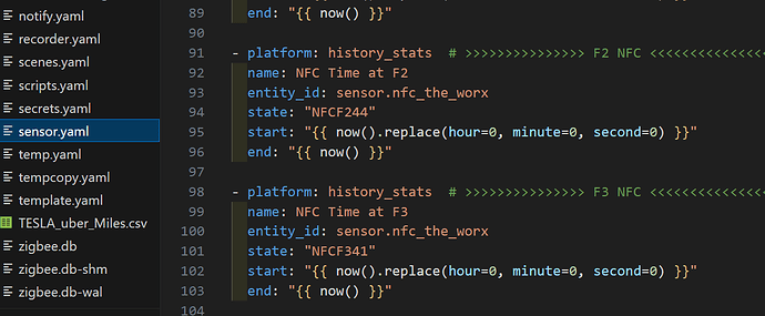

so I restore my previous version of HA because my automations stopped working due to that migration, but I would like to go back to the newest HA and fix that issue, so how can I keep my sensors if I remove sensors setup from YAML?
my sensors setup
ERROR after migration
Automation
So depends on my location or NFC tag scanned timestamp is recorded like below
How should I convert to the new notify.send_message service call if I cant have my sensors?

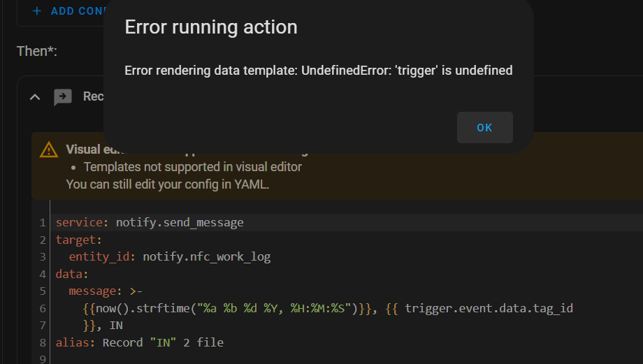

Everything looks good now, but when I try to run one off the actions I’m getting an error
and it was perfectly fine before the migration
if you run an automation, there is no trigger, so no trigger.event.data.tag.id. You need to scan a tag.
got it!
