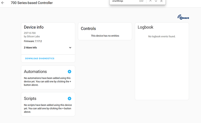

Is there a straightforward way to migrate my Zwave and Zigbee devices from a SmartThings Hub to my HA server?
I have about 25-30 devices. Here’s a sample device in ST:
HA has the following:
Thank you!
