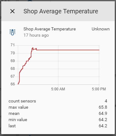

Ok, this has happened again and I have looked at more things. I think I see the issue, but I’m not sure why it is happening.
Here is the config entry:
  - platform: min_max
    name: "Shop Average Temperature"
    type: mean
    round_digits: 1
    entity_ids:
      - sensor.shop_multisensor_temperature
      - sensor.shop_cart_temperature
      - sensor.shop_entry_temperature
      - sensor.shop_finishing_room_temperature
Here is the history of the min_max sensor:
ShopClimatePlot
The temperature sensor individually:
The units of the unavailable sensor (it should be DegF, but it isn’t):
Once the sensor comes back, the units change back to DegF as expected:
I am not sure why the unit changes, but I am going to try adding this to my customize.yaml file to try and prevent the behavior. We’ll see if it works.
