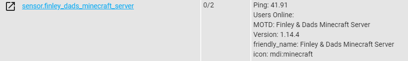

I am trying to set an automation off based on activity (i.e. a user connected to my home minecraft server) I have the sensor in Home Assistant working perfectly but I dont know what sort of automation i need (number, state etc …)
These are the results from the sensor;

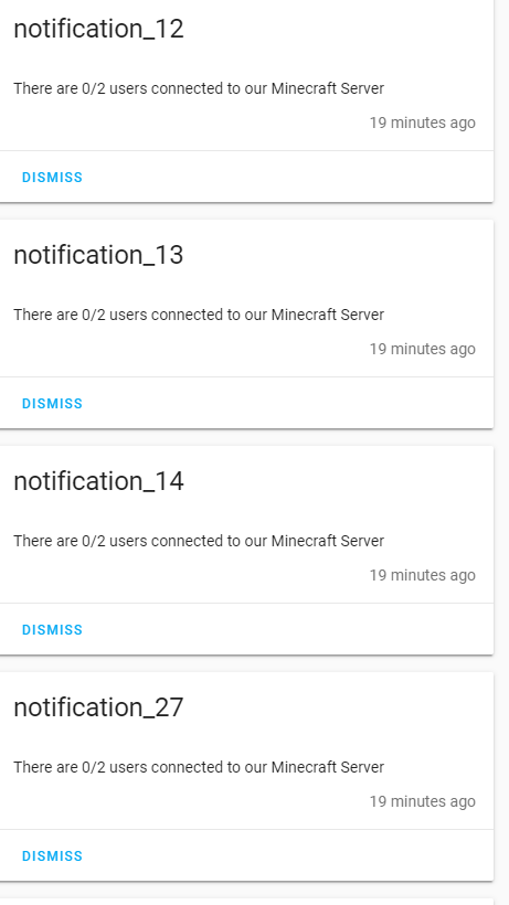

This just gave me hundreds of notifications when no one was connected ?
Ideally I want a message when it becomes greater that 0 and thats it

Oh. That’s not good. It should only notify you when the state changes. Maybe it goes “unavailable” a lot?

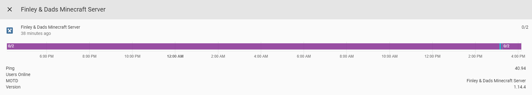

What does the history of the sensor look like?
Add an entities card to Lovelace with the sensor.finley_dads_minecraft_server
entity and click on it to see the more info history pop-up.

Click on the title of the pop-up again so it expands to fill the screen so we can see how many cyan state changes are in that one bit. It does look like more than one.

Looking at that you should have got 4 notifications (someone, no one, someone, on one). Not hundreds.
I would template the “Users online:” attribute instead of the state. Something is triggering the state to change, likely to do with the component/integration.

Hmm. Maybe it’s triggering when the attributes change as well (ping could be the culprit). Sorry about having to delete all those notifications. A restart will clear them more easily than pressing “X” 635 times.

its the ping, sat watching the sensor and every 30 secs or so when the ping moves i get a message

Hmmm, why is the Users Online:
attribute empty? That’s not helping.
