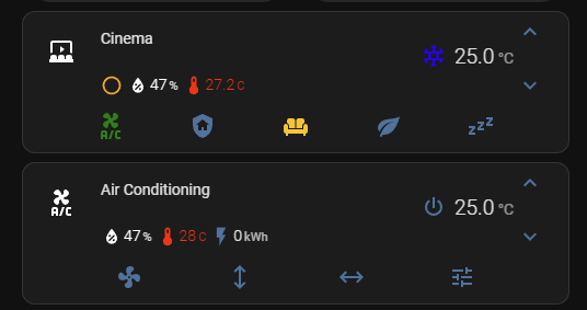

Here we go:
How do you get the preset icons on the low row ? Can you share the code ? Thanks…
Great card, thank you ! But not easy to configure for me…
type: custom:mini-climate
entity: climate.cinema
card_mod:
  style: |
    ha-card {
      {% set mode = states('climate.cinema') %}
      {% if mode == 'heat' %}
        background: rgba(255, 165, 0, 0.15) !important;
        border: 2px solid orange !important;
      {% elif mode == 'cool' %}
        background: rgba(0, 0, 255, 0.15) !important;
        border: 2px solid blue !important;
      {% else %}
        background: rgba(255, 255, 255, 0.05) !important;
        border: 2px solid rgba(255, 255, 255, 0.2) !important;
      {% endif %}
    ha-icon {
      color: white !important;
icon: mdi:theater
hide_current_temperature: true
target_temperature:
  step: 0.5
  value:
    style: |
      (value) => (value > 30 ? { color: 'red'} : { color: 'green'})
secondary_info:
  hide: true
toggle:
  hide: true
  default: true
hvac_mode:
  style: |-
    (value, entity) => {
      if (value === 'heat') return { color: 'orange !important' };
      if (value === 'cool') return { color: 'blue !important' };
      return { color: 'gray !important' };
  hide: false
  source:
    heat:
      icon: mdi:fire
    cool:
      icon: mdi:snowflake
indicators:
  preset:
    icon:
      template: |
        (value) => (!value || value === '')
          ? 'mdi:hand-back-right-outline'
          : 'mdi:circle-outline'
      style: |
        (value) => {
          if (!value || value == '') {
            return { color: 'white' };
          } else if (value === 'building_protection') {
            return { color: 'red' };
          } else if (value === 'comfort') {
            return { color: 'orange' };
          } else if (value === 'economy') {
            return { color: 'green' };
          } else if (value === 'standby') {
            return { color: 'dodgerblue' };
          } else {
    tap_action:
      action: more-info
    value:
      style: |
        () => ({display: 'none'})
    source:
      attribute: preset_mode
  humidity:
    icon:
      template: () => 'mdi:water-percent'
      style: |
        (value) => {
          if (value > 60) {
            return { color: 'CadetBlue' };
          } else if (value > 40) {
          } else {
    value:
      style: |
        (value) => {
          if (value > 60) {
          } else {
    tap_action:
      action: more-info
      entity: sensor.office_t_h_sensor_humidity
    unit: "%"
    round: 0
    source:
  temperature:
    icon:
      template: () => 'mdi:thermometer'
      style: |
        (value) => {
          if (value > 27) {
          } else if (value < 4) {
          } else {
    value:
      style: |
        (value) => {
          if (value > 27) {
          } else {
    tap_action:
      action: more-info
      entity: sensor.office_temperature
    unit: C
    round: 1
    source:
buttons:
  switch:
    icon: mdi:air-conditioner
    state:
      entity: switch.cinema_air_conditioning_knx_switch
    style: |
      (state) => ({
        color: state === 'on' ? 'gray' : 'green'
    toggle_action: |
      (state) => this.call_service('switch', 'toggle', {
        entity_id: 'switch.cinema_air_conditioning_knx_switch'
  building_protection:
    icon: mdi:shield-home
    state:
      mapper: "(state, entity) => state === 'building_protection' ? 'on' : 'off'"
    toggle_action: |
      (state) => this.call_service('climate', 'set_preset_mode', {
        entity_id: 'climate.cinema',
        preset_mode: 'building_protection'
  comfort:
    icon: mdi:sofa
    state:
      mapper: "(state, entity) => state === 'comfort' ? 'on' : 'off'"
    toggle_action: |
        preset_mode: 'comfort'
  economy:
    icon: mdi:leaf
    state:
      mapper: "(state, entity) => state === 'economy' ? 'on' : 'off'"
    toggle_action: |
        preset_mode: 'economy'
  standby:
    icon: mdi:sleep
    state:
      mapper: "(state, entity) => state === 'standby' ? 'on' : 'off'"
    toggle_action: |
        preset_mode: 'standby'
fan_mode:
  hide: true

Eventually managed to get something great with this card despite a poor documentation, thanks to @MrHollow , ChatGPT and ClaudeAI !
In my situation, my climate entity controls only electric radiators. I don’t need any fan or cooling controls. If this is the simpliest case, it is hard to manage with the card without being good at code…
Here is my card :
And here is the code for that :
entity: climate.thermostat_bureau
icon: mdi:desk-lamp
target_temperature:
  step: 0.5
fan_mode:
  hide: true
toggle:
  hide: true
  default: true
secondary_info:
  icon: mdi:window-open-variant
  hide: |
    (climate_entity) => climate_entity.attributes.window_state !== 'on'
hvac_mode:
  style: |-
      if (value === 'off') return { color: 'gray !important' };
      if (entity.attributes?.hvac_action === 'heating') return { color: 'orange !important' };
  hide: false
  source:
    "off":
      icon: mdi:power-off
    heat:
      icon: mdi:heat-wave
card_mod:
  style: |
    ha-icon {
      color: var(--state-icon-color) !important;
    .state__icon {
      color:
          const a = entity.attributes.hvac_action;
          if (!a) return 'var(--state-icon-color)';
          return a === 'heating' ? 'orange' : 'var(--state-icon-color)';
indicators:
  temperature:
    icon: mdi:thermometer
    tap_action:
      action: more-info
      entity: sensor.sonde_bureau_temperature
    unit: C
    round: 1
    source:
  humidity:
    icon: mdi:water-percent
    tap_action:
      action: more-info
      entity: sensor.sonde_bureau_humidity
    unit: "%"
    round: 0
    source:
  battery:
    hide: |
      (value) => value > 20
    icon:
      template: |
        (value) => (value > 20)
          ? 'mdi:battery-20'
          : 'mdi:battery-10'
      style: |
        (value) => {
          if (value < 20) {
            return { color: 'red' }; // Above high threshold
          } else {
            return { color: 'orange' }; // Below low threshold
    value:
      style: |
        (value) => {
          if (value < 20) {
          } else {
    unit: "%"
    round: 0
    source:
      entity: sensor.sonde_bureau_battery
buttons:
  frost:
    icon: mdi:snowflake
    state:
      mapper: |
        (state) => state === 'frost' ? 'on' : 'off'
    style: >
      (state, entity) => entity.attributes.preset_mode === 'frost' ? { color:
      'deepskyblue' } : { color: 'var(--disabled-text-color)' }
    toggle_action: >
      (state, entity) => this.call_service('climate', 'set_preset_mode', {
      entity_id: entity.entity_id, preset_mode: 'frost' })
  eco:
    icon: mdi:leaf
    state:
      mapper: |
        (state) => state === 'eco' ? 'on' : 'off'
    style: >
      (state, entity) => entity.attributes.preset_mode === 'eco' ? { color:
      'limegreen' } : { color: 'var(--disabled-text-color)' }
    toggle_action: >
      entity_id: entity.entity_id, preset_mode: 'eco' })
  comfort:
    icon: mdi:sofa
    state:
      mapper: |
        (state) => state === 'comfort' ? 'on' : 'off'
    style: >
      (state, entity) => entity.attributes.preset_mode === 'comfort' ? { color:
      'orange' } : { color: 'var(--disabled-text-color)' }
    toggle_action: >
      entity_id: entity.entity_id, preset_mode: 'comfort' })
  boost:
    icon: mdi:fire
    state:
      mapper: |
        (state) => state === 'boost' ? 'on' : 'off'
    style: >
      (state, entity) => entity.attributes.preset_mode === 'boost' ? { color:
      'red' } : { color: 'var(--disabled-text-color)' }
    toggle_action: >
      entity_id: entity.entity_id, preset_mode: 'boost' })
The icon left to the temperature control is orange colored when radiator is heating.
The secondary information displays an opened window icon when one window is opened in the room (it is an template entity).
Would like to increase the font size for the name but this doesn’t look possible at this time.
I want to encourage this card. It is a great card, very versatile, but hard to customize due to poor documentation. It replace the abandonned ‘simple-thermostat’ card.
Hope that will help !
Glad I could help
