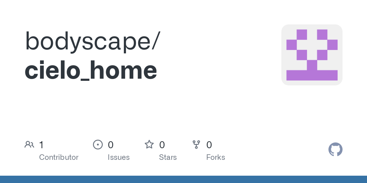

Hey i reverse engineering Cielo Home (https://home.cielowigle.com/) and i made a HACS integration. Work pretty well. Give me your thought
Have fun!
Thank you for doing this. I will be installing later and test.
I was wondering on the Celio Wifi Controler you can turn off the LED Temperature light on the mini split. In the documentation I do not see the ability to control this. Is that not an option yet?
Yes, i will integrate it when i have more time! :wink: But in my Cielo app i have a button to turn on and off the light. But i don’t have the state of the light is on or off. Not so clean, so i HA i can add a button to do that but you can’t see the state of light in HA. Cielo appear to not support that state or is my HVAC. i have no idea. I will check if there any other way… @justin450
@justin450 the version 1.4.1 support the light!
Awesome, I will update to 1.4.1
Everything besides the light did work for me on the previous version. Thanks again!
Thank you @bodyscape for building this integration! Super useful. I am facing couple of issues while trying to use it
  1. It doesn’t seem like HA is reflecting the changes to the AC state which are happening outside it’s knowledge. e.g. if I use the remote control to turn the AC off or on, it doesn’t reflect on the device state as visible on HA
  2. My AC and remote, both have LED switch on/off support, but it’s not showing up on my HA device
Could you please help me debug? Also, I have just started using HA a few days back. Still learning the basics
@homefun my integration don’t support the state for the LED switch. Did you try to change settings with the mobile app of Cielo Home? Everything work great for me when i change setting with the remote or the mobile app.
