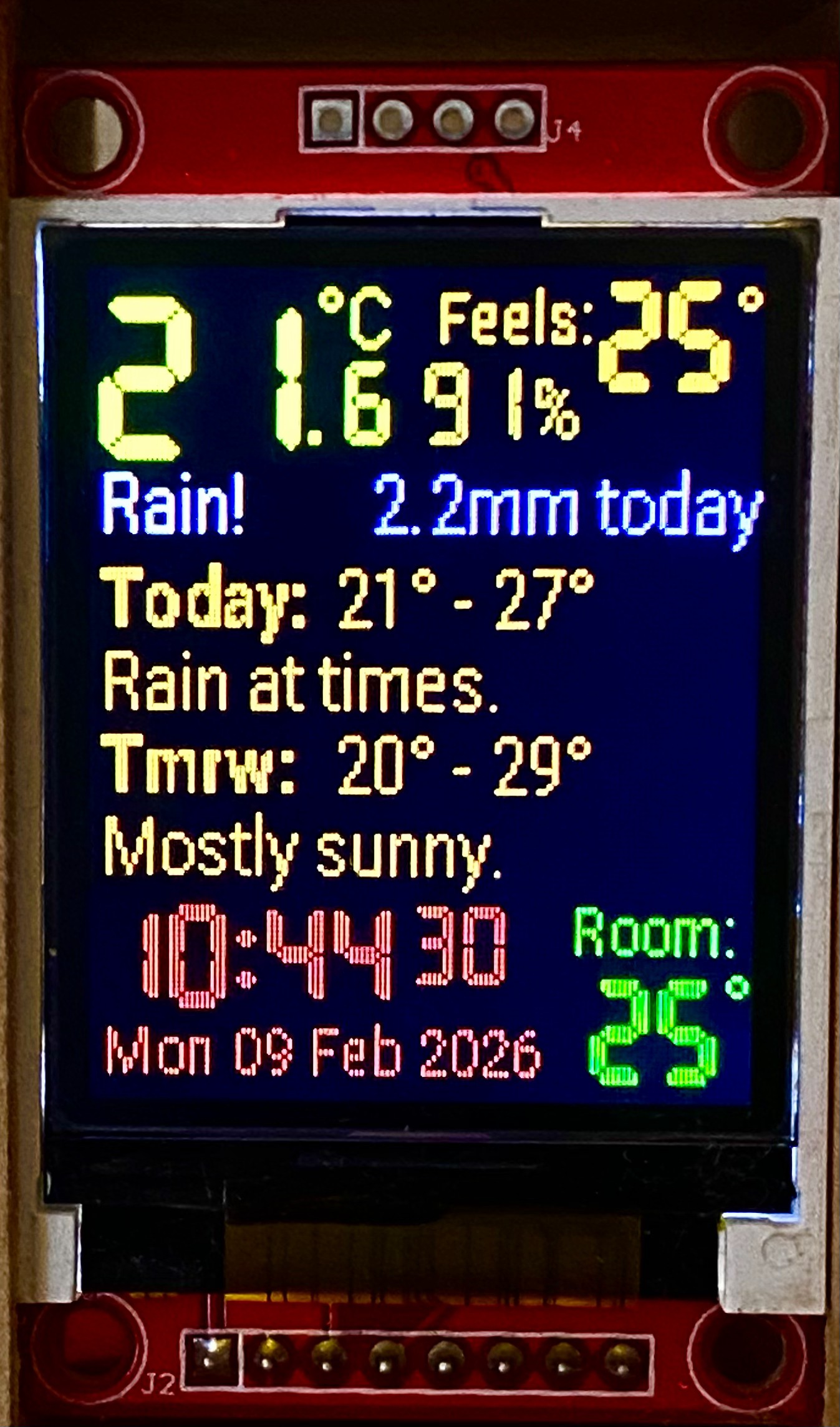

Sharing a bedside current weather conditions display that uses ESPHome and a small TFT screen, importing most sensor readings from HA.
This provides at-a-glance access to important questions like “is it raining?”, “what’s the temp outside?”, “what is today’s forecast?”, “Is the room hot, or is it just me?”, without having to lift a finger or access your phone etc. You can now check conditions before getting out of bed and selecting an outfit for the day :slight_smile: .
Looks better in real life!

Details on screen (L>R, T>B):
  • Current outside temperature (SHT31 sensor, via HA)
  • Current outside humidity (SHT31 sensor, via HA)
  • Current “feels like” temperature (via calculations in HA)
  • Rain / no rain indicator (custom sensor, via HA)
  • Rainfall today (custom tipping-bucket sensor, via HA)
  • Forecast max/min/synopsis for today & tomorrow (from Aust BoM, via HA)
  • Current time (via HA)
  • Current day / date (via HA)
  • Current room temperature (from existing room sensor, via HA)
Other features of note:
  • “Retro” 7-segment display font in use for main readings, with custom spacing for better readibility - and an old-school flashing colon in the time!
  • Rain detail display is dynamic and only displayed if relevant.
  • Forecast details change from for Min - Max (today) & Min - Max (tmrw) to Max - Min (today) and Max (tmrw) as BoM updates details.
  • I use Aust BoM feels-like calculations plus my PWS temp/wind/humidity readings to generate a truly local “feels like”.
  • Custom scrolling text function is used for synopsis details to ensure the full “mini synopsis” sourced from BoM is displayed.
  • Display is dimmed at night / low-light to prevent sleep interruption.

      it.printf(it.get_width()-5, 3, id(font_3r_s3), amber, TextAlign::RIGHT, "%.0f", id(Temp_feels).state);
      // ===== Indoor (room) temperature
      it.printf(it.get_width(), 118, id(font_2r_s2), green, TextAlign::RIGHT, "Room: ");
      it.printf(it.get_width(), 132, id(font_2r_s1), green, TextAlign::RIGHT, "°");
      it.printf(it.get_width()-5, 136, id(font_3r_s3), green, TextAlign::RIGHT, "%.0f", id(Temp_BedM).state);
      // ===== Raining indicator
      if (id(Rain_check).state) {
        it.printf(2, 36, id(font_2r_s1), white, "Rain!");
      if (id(Today_rain).state) {
        it.printf(it.get_width(), 36, id(font_2r_s1), blue2, TextAlign::RIGHT, "%.1f mm today", id(Today_rain).state);
      //===== Add BOM forecast details
      it.printf(2, r_BOM1, id(font_5r_s1), amber, "Today:");
      it.printf(2, r_BOM3, id(font_5r_s1), amber, "Tmrw:");
      // Display Min > Max OR Max > Min plus tomorrow details
      if (isnan(id(Temp_min).state)) {
        it.printf(47, r_BOM1, id(font_2r_s1), amber, "%.0f° - %.0f°", id(Temp_max).state, id(Temp_min1).state);
        it.printf(47, r_BOM3, id(font_2r_s1), amber, "%.0f°", id(Temp_max1).state);
      else {
        it.printf(47, r_BOM1, id(font_2r_s1), amber, "%.0f° - %.0f°", id(Temp_min).state, id(Temp_max).state);
        it.printf(47, r_BOM3, id(font_2r_s1), amber, "%.0f° - %.0f°", id(Temp_min1).state, id(Temp_max1).state);
      // Display synopsis (scrolling) for today
      it.get_text_bounds(0, 0, id(Weather_today).state.c_str(), id(font_2r_s1), TextAlign::TOP_LEFT, &x1, &y1, &sct_width, &sct_ht);  // Determine the pixel length of text line
      if (sct_width > disp_width) {
        it.printf(sct_pos, r_BOM2, id(font_2r_s1), amber, "%s", id(Weather_today).state.c_str());  // Redraw text at the current scroll position
        sct_pos -= 2; // Update the scroll position for the next update_interval by moving left 2 pixels
        if (sct_pos < -sct_width) {   // If the text has scrolled completely off-screen, reset its position
          sct_pos = 2;    // Set scroll start position to start of line.
      else {      // If text fits, just display it statically
        it.printf(2, r_BOM2, id(font_2r_s1), amber, id(Weather_today).state.c_str());
        sct_pos = 0; // Reset global variable if no scrolling needed
      // Display synopsis (scrolling) for tomorrow
      it.get_text_bounds(0, 0, id(Weather_tmrw).state.c_str(), id(font_2r_s1), TextAlign::TOP_LEFT, &x2, &y2, &sct2_width, &sct2_ht);  // Determine the pixel length of text line
      if (sct2_width > disp_width) {
        it.printf(sct2_pos, r_BOM4, id(font_2r_s1), amber, "%s", id(Weather_tmrw).state.c_str());  // Redraw text at the current scroll position
        sct2_pos -= 2; // Update the scroll position for the next update_interval by moving left 2 pixels
        if (sct2_pos < -sct_width) {   // If the text has scrolled completely off-screen, reset its position
          sct2_pos = 2;    // Set scroll start position to start of line.
        it.printf(2, r_BOM4, id(font_2r_s1), amber, id(Weather_tmrw).state.c_str());
        sct2_pos = 0; // Reset global variable if no scrolling needed
      //===== Day / date
      it.strftime(2, 142, id(font_2r_s2), red, "%a %d %b %Y", id(homeassistant_time).now());
