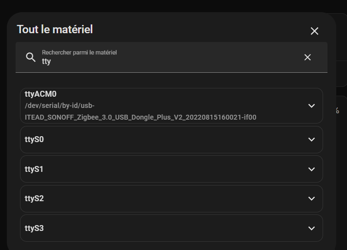

I suggest to check the “hardware”.
My UI in french - click “Tout le matériel”.
I have one system where I do not manage the leds in HA (I run HA on proxmox):
On the other one, I have the script, but I can’t find /dev/ttyUSB0 - possibly because I did not manage it in HA after all on that system.

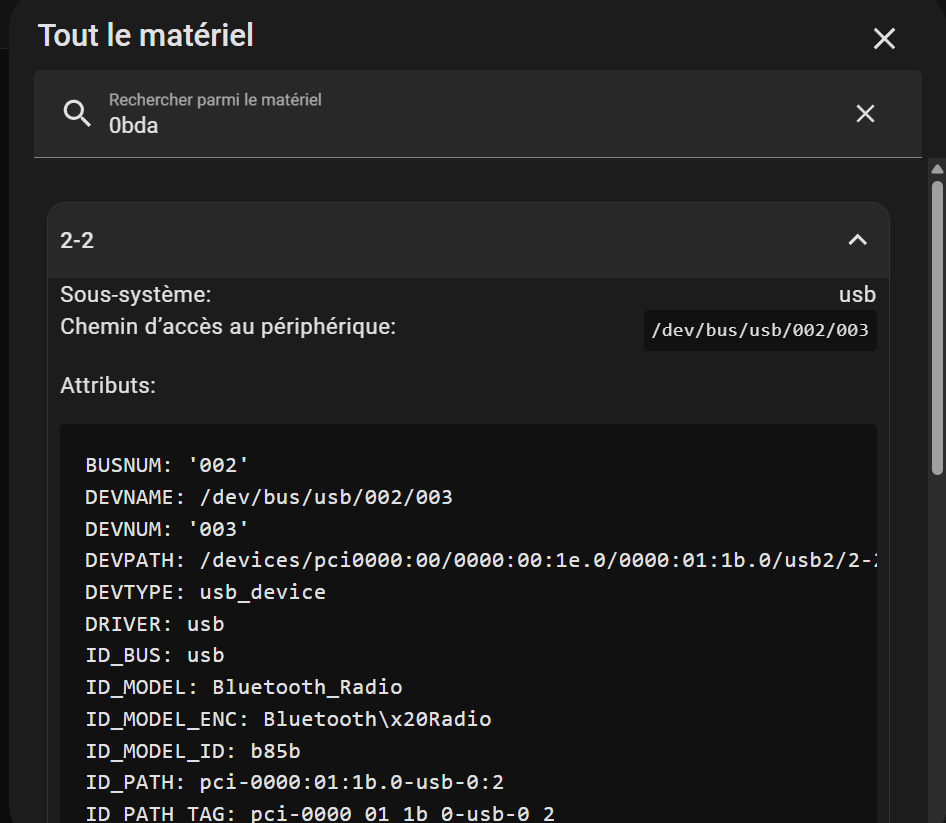

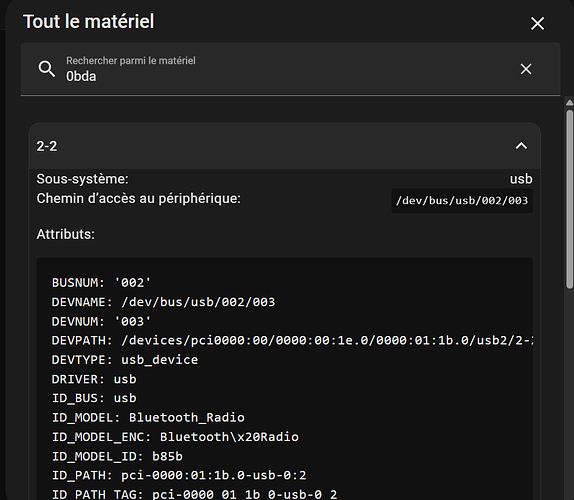

lsusb on the proxmox host shows me:
Bus 001 Device 002: ID 0bda:b85b Realtek Semiconductor Corp. Bluetooth Radio
Bus 002 Device 001: ID 1d6b:0003 Linux Foundation 3.0 root hub
Bus 001 Device 005: ID 1a86:7523 QinHeng Electronics CH340 serial converter
And we can see that looking up 0bda gives the path tot the device.

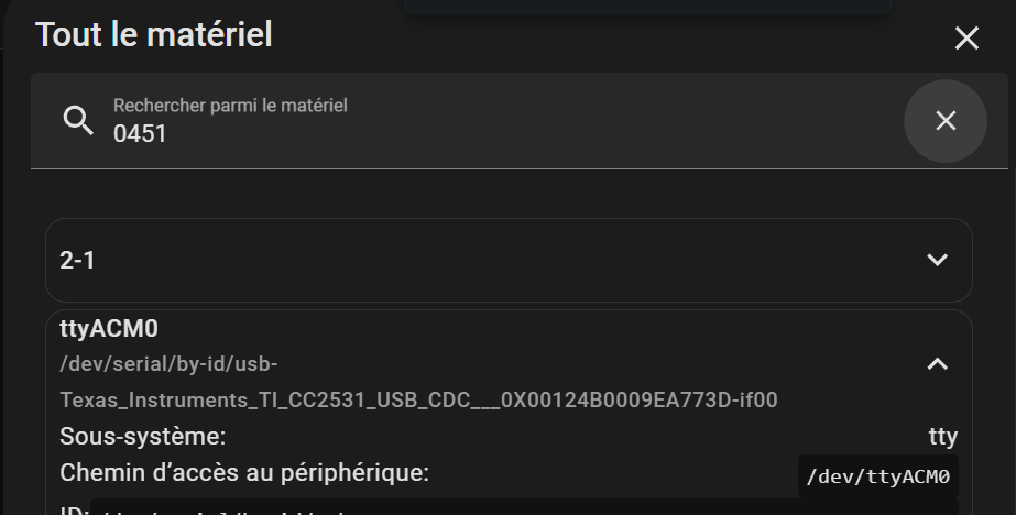

For my zigbee stick, I get, showing that it is at /dev/ttyACM0:
So by checking your hardware as seen by HA, you can check if it is found, and where it is mapped.
I did not map the leds (1a86), so I can not show it.
