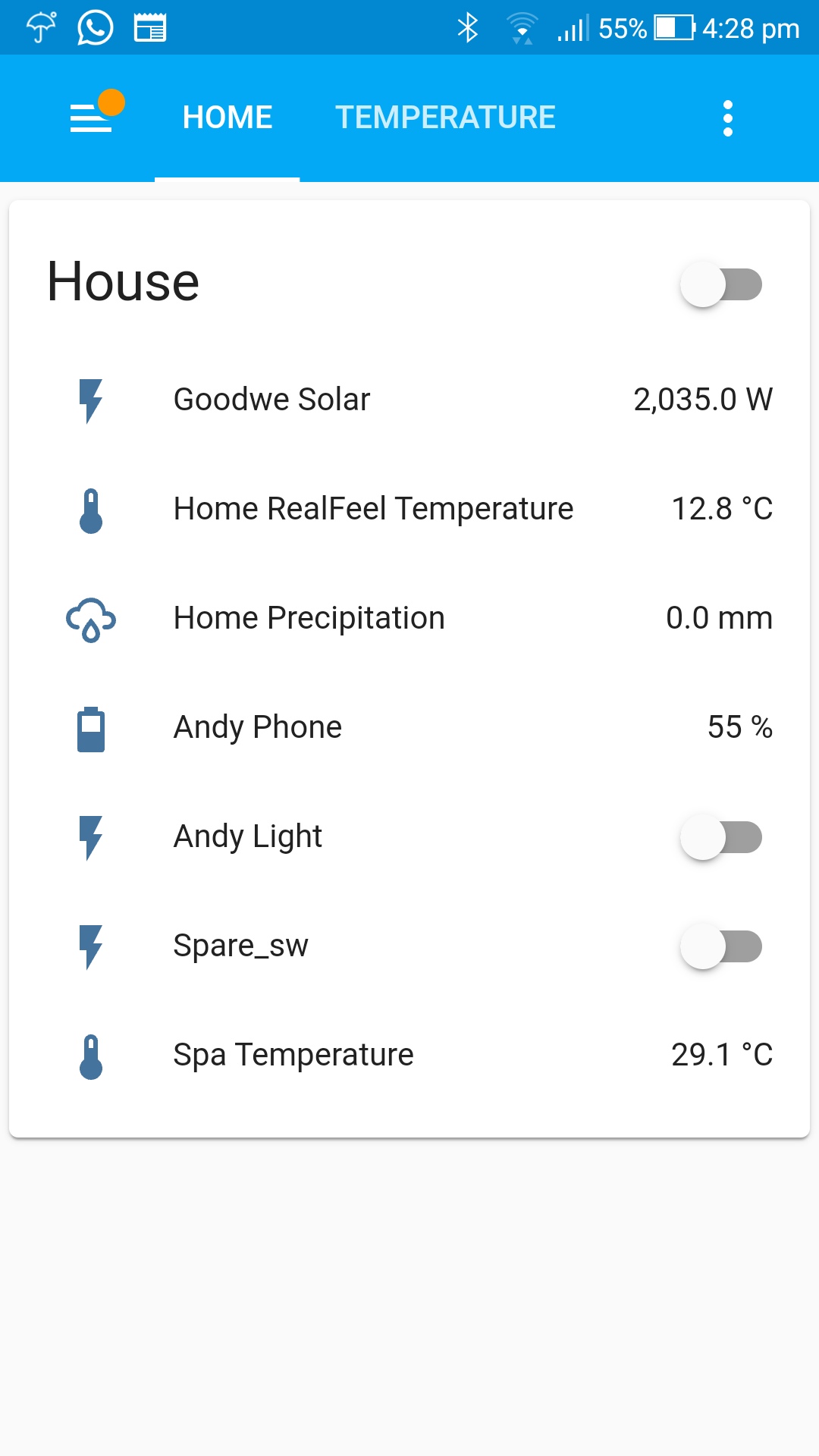

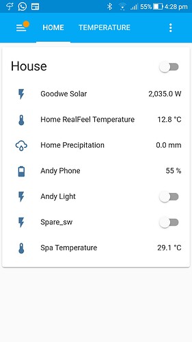

I’m having trouble seeing all the dashboard cards on my mobile devices.
They are all there when I use any browser on my PC but on the Overview Home tab on my Android phone, only the first card is visable. I get the same result with an Iphone and Ipad.
I have tried reinstalling the app and restoring HA to a previous version but it didn’t fix it.
PS The cards on the Temperature are ok ie all displayed
Any ideas ??
Screen shot of PC and Phone attached
