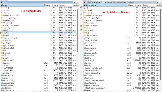

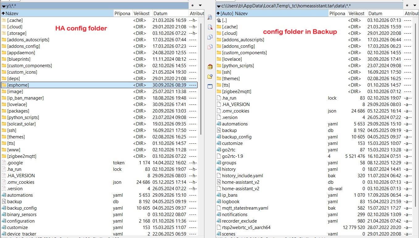

Missing folders www, packages, esphome, solcast_solar, .... in Backup?
After ages w/o need of touching backup I needed to copy particular .yaml file from my latest backup but noticed that in backups are missing folders with config and lovelace files. I run backup with media excluded only. Difference between actual /config folder and the same folder from homeassistant.tar is on the printscreen. While I compare backups from 2 HA devices, I came into finding that change happened somewhere between a.) core 2026.9.4/Supervisor 2026.9.3 and b.) core 2026.8.1/Supervisor 2026.07.5. where. a.) performes backup with missing files and folders, b.) performed full backups as expected. In both cases I use no encryption. Backup settings are the same for all backups. The difference I am speaking about you can see on the screenshot

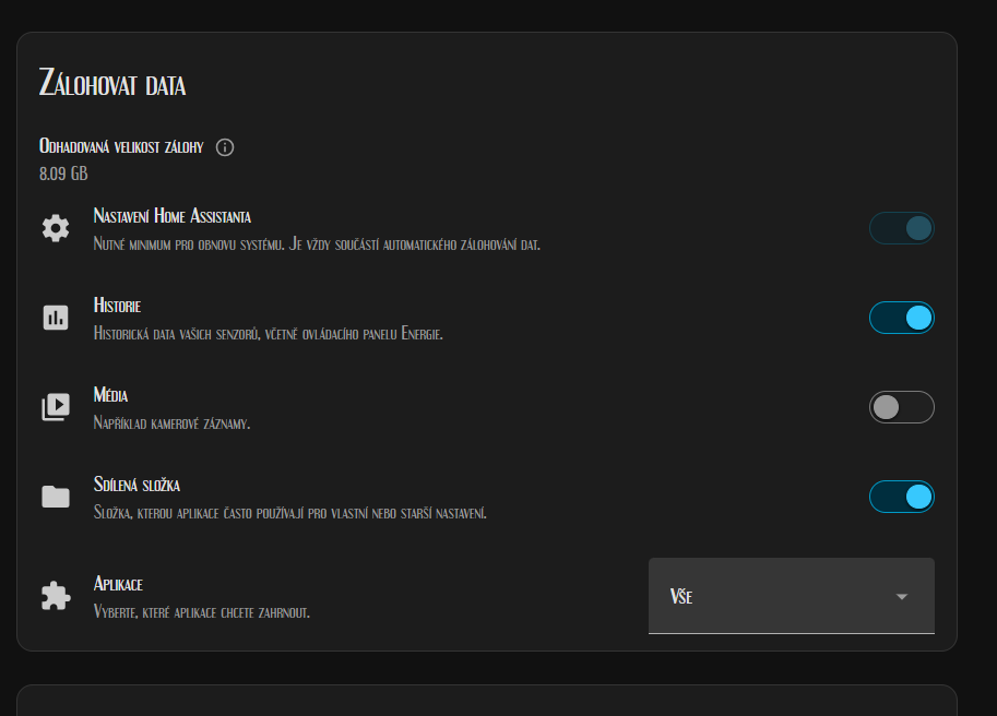

Could you maybe show your backup-settings ?
Is i.e /Share included, And /Apps ? (that includes folders used by Apps)
Also could you maybe “line this up” a better way, as it’s pretty hard to understand , a.) b.) b.) a.) , when it’s smashed up like it is
i.e
Make a complete backup, with All Apps included
Make sure Auto-backups also included what you require

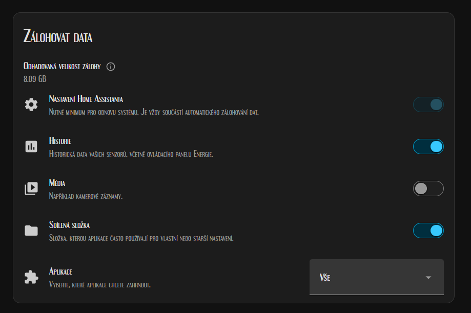

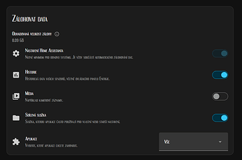

This is setting for manual backup:
So what does, the Last #Toggle, in that Pic says ? … Sorry im not familiar with your language.

If I run (on core 2026.9.4/Supervisor 2026.9) manually backup from Settings/System/Backup - with settings:
without encryption, in the resulted xyz.tar file, after unpacking, in homeassistant.tar, there are missing folders: blueprints, packages, ip_ban_manager, esphome, solcast_solar, www and some .yaml files from config/ .
If I do the same steps (on core 2026.8.1/Supervisor 2026.07.5) all files/folders listed above are included.
So in my view it is not about Samba Backup itself only. But about backup in general. Well in my case at least.
The selector in Apps says All.

I admit, your screenshot of “missing” files/folders looks peculiar

Ok, seems like it does what it’s told to … so if your still “missing” something, maybe it just got tired after 23min, and called it the day :laughing:
I really have no ideas, try to report a bug in Github CORE/Backup Component
How big is your backup-files really ?
Up to 6Gb.
This “not complete” backup is 5,6 Gb + separately packed ‘missing files’ approx 0,2Gb.
