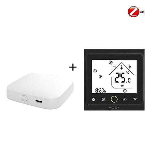

I have exactly the same issue with the latest MOES TS0601 zigbee thermostats (
_TZE204_xalsoe3m). Device only creates separate sensor wich indicates idle/heating condition.
You are asking about zwave and posted a link to a zigbee thermostat
Right @PeteRage, may bad… however issue looks exactly the same.
@Lavoie005, I have “solved” this by creating new additional generic thermostat + template switch. That generic thermostat works as it should, but instead of measuring and controling real devices it just giving commands (heat ON/OFF by setting set temperature high/low) to real thermostat. Works just perfect, even better then real device (doesn’t require temperature offsets, etc)
