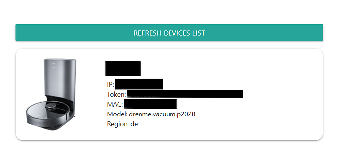

I have a Dreame Z10 Pro Laser vacuum cleaner wich works over the Xiaomi App.
I want to integrate the robot in Home Assistant, but i seems like the robot is not supported.
Please add the model dreame.vacuum.p2028 in the integration.
Thanks.
-Marco
