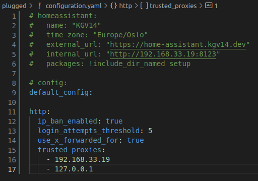

This is my current config. Still no server controls.
Just to be sure, did you try clearing your browser cache? What version of HA?
