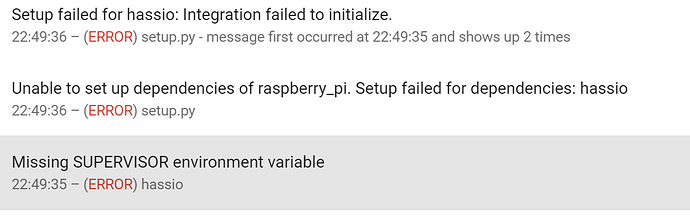

I moved my config folder over to the new machine and mapped it to my container. Everything is now working great! Except I always get these 3 errors on startup-

What can I do to get rid of these errors? Thank you!

I’m doing the same process after my SD card died . I was able to remove the error by removing the raspberry_pi entry in .storage/core.config_entries.
I’m not sure if this is correct, but I don’t have any issues. Please back up everything.
For example, I deleted this entry:
"entry_id": "",
"version": 1,
"domain": "raspberry_pi",
"title": "Raspberry Pi",
"data": {},
"options": {},
"pref_disable_new_entities": false,
"pref_disable_polling": false,
"source": "system",
"unique_id": null,
"disabled_by": null
Make sure you delete the preceding comma or you’ll get a json error.

Thank you Jason! This worked for me!
great! this worked, thanks
