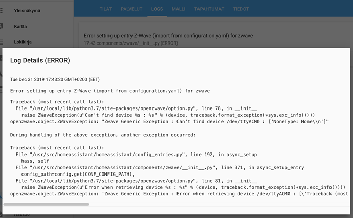

I’m having the same. How do you get to the “core-ssh” level of ssh (I imagine outside of Home Assistant)? I started off Home Assistant image and would really like to have full Raspberry Pi -level ssh access.
You’re using a Pi 4 with the Aeotec Z-stick. This has a known issue (which sounds like it’s the Pi’s fault).
I had the same issue and wracked my brain on it for hours before too much googling pointed me to finding out that I needed to plug the z-stick into a USB 2 hub (NOT 3!). It cost me $9 USD and solved all of my issues.

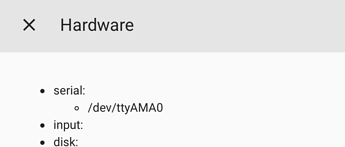

As far as I know, /dev/ttyAMA0 is the “Tx, Rx pins for the Raspberry”.
The real thing is that Aeotec Z-Stick Gen5 seems to be incompatible with Raspberry Pi 4, on an electrical level. Details are here. The original author’s works because he’s running on RPi 3.
