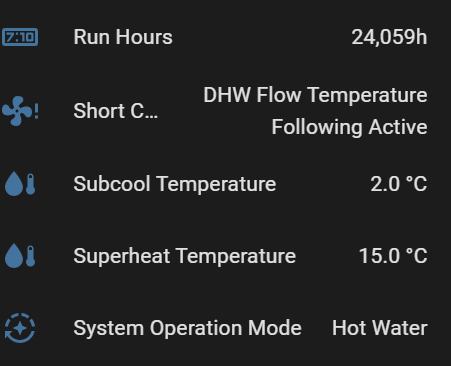

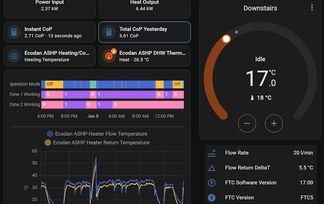

Since 2024 i have been using this adapter which connects to the Mitsibushi Ecodan/Zubadan/Geodan Air-to-Water Heat Pump controller and provider over 120 entities of control and additional data into Home Assistant via MQTT (with auto-discovery).
The GitHub has loads of documentation on the features from simple to advanced.
It’s a great way to control your Ecodan locally and provide controls hidden by Mitsibushi.
I hope this helps some of you who don’t wish to solder and have a really simple plug & play device for your heat pumps at an affordable price

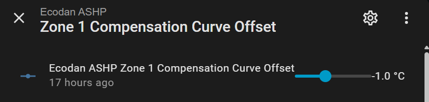

We have our own takes on things, and you mentioned the most advanced features for expert users. Released in the summer last year i did my onboard comp curve (bridging the gap to AA with Vaillant style) while Gekkekoe went full AA as an altrenative.

I use this integration (hardware and software) to control my Ecodan R290 and I have to say it’s excellent. It’s very reliable and easy to easy to use for dashboarding and automation. F1p is very fast at responding to questions too. Thanks f1p.
