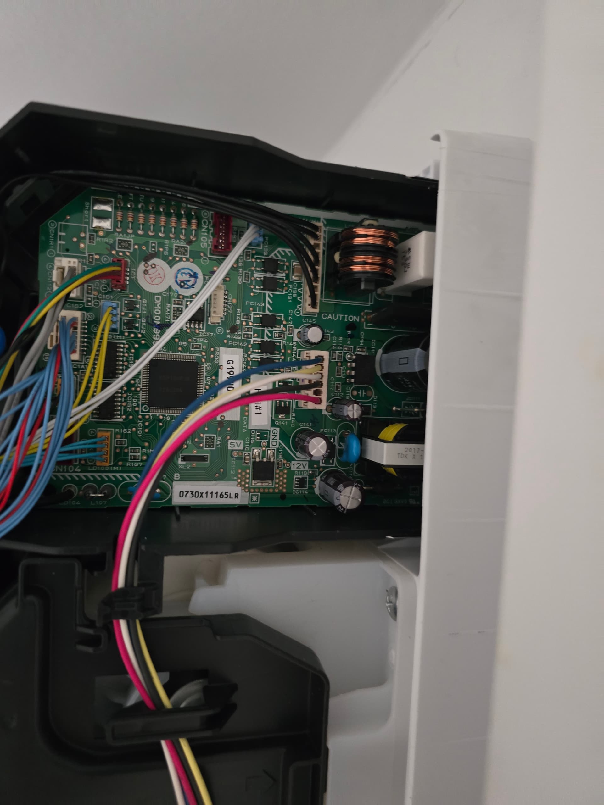

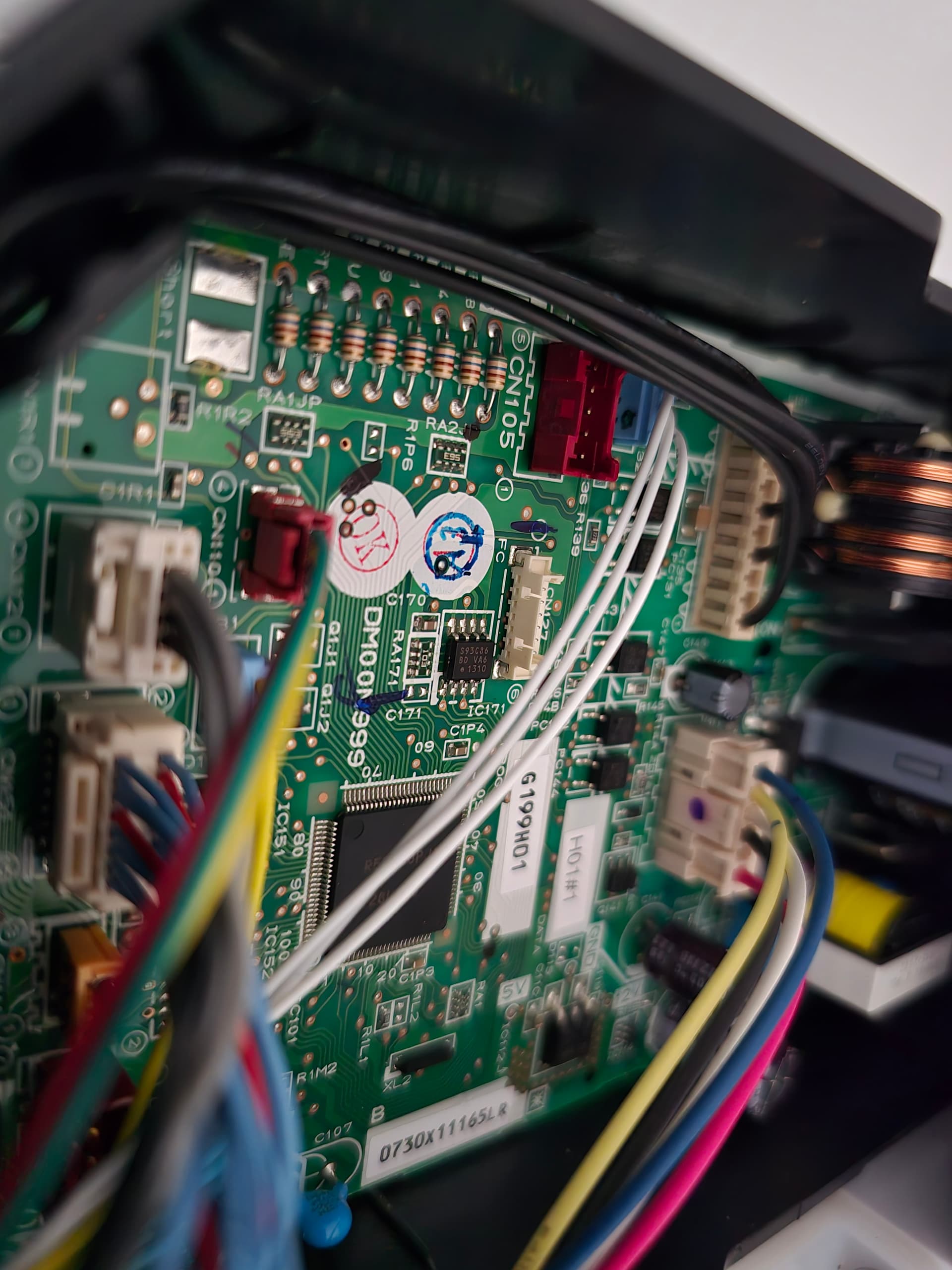

I tried to tackle this last year, ordered the ESP Boards and the Cables but then never got anywhere. The plug just didn’t fit on my MSZ-AP25VGK Unit and I didn’t want to risk damaging the AC by plugging something incorrectly.
Now, a year later I am checking back in to see if there is some kind of more “Plug and Play” solution to this. Unfortunately it appears the answer is “mostly no” if I read correctly…:man_shrugging:
Do you have any photos of the board where the cable wouldn’t plug in?
The website mentions “built-in Wi-Fi Energy Monitoring”… often the Mitsubishi wifi controllers will be plugged into the same port we use for the ESP.
I tried to use the port the WiFi Dongle was plugged into. It has the right shape, but not the “indentations” the aliexpress plugs have.
I will have to check if I took any photos of the board last year.

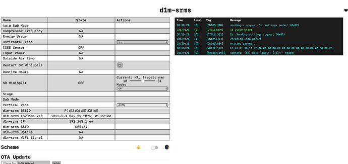

After the 2025.5.1 ESPHome update my Mini-Split has stopped reporting. I can still connect to the device, but no data back to HA. The logs have several errors, but I think this is the most relevant:
Logger: homeassistant.components.mqtt.models
Source: components/mqtt/models.py:366
integration: MQTT (documentation, issues)
First occurred: May 29, 2025 at 6:41:02 PM (6928 occurrences)
Last logged: 8:32:52 PM
Exception raised while updating state of climate.d1m_sr_minisplit, topic: 'd1m-srms/climate/sr_minisplit/target_temperature/state' with payload: b'nan'
Exception raised while updating state of climate.d1m_sr_minisplit, topic: 'd1m-srms/status' with payload: b'online'
Exception raised while updating state of climate.sr_minisplit_sr_minisplit, topic: 'd1m-srms/climate/sr_minisplit/target_temperature/state' with payload: b'nan'
Exception raised while updating state of climate.sr_minisplit_sr_minisplit, topic: 'd1m-srms/status' with payload: b'online'
  File "/usr/src/homeassistant/homeassistant/components/mqtt/models.py", line 366, in process_write_state_requests
    entity.async_write_ha_state()
  File "/usr/src/homeassistant/homeassistant/helpers/entity.py", line 1019, in async_write_ha_state
    self._async_write_ha_state()
  File "/usr/src/homeassistant/homeassistant/helpers/entity.py", line 1141, in _async_write_ha_state
    self.__async_calculate_state()
  File "/usr/src/homeassistant/homeassistant/helpers/entity.py", line 1083, in __async_calculate_state
    if state_attributes := self.state_attributes:
  File "/usr/src/homeassistant/homeassistant/components/climate/__init__.py", line 420, in state_attributes
    data[ATTR_TEMPERATURE] = show_temp(
        hass,
    ...<2 lines>...
        precision,
  File "/usr/src/homeassistant/homeassistant/helpers/temperature.py", line 34, in display_temp
    return round(temperature * 2) / 2.0
ValueError: cannot convert float NaN to integer
Has anyone had similar issues since the recent update? Or should I just assume the upload failed in some way? I can pull the device and re-flash it if necessary.
Any advice?
I can access the device but it seems to not be updating. Pressing the RESTART button does not seem to work either, so I think the device is not communicating with Home Assistant.
Thanks.
