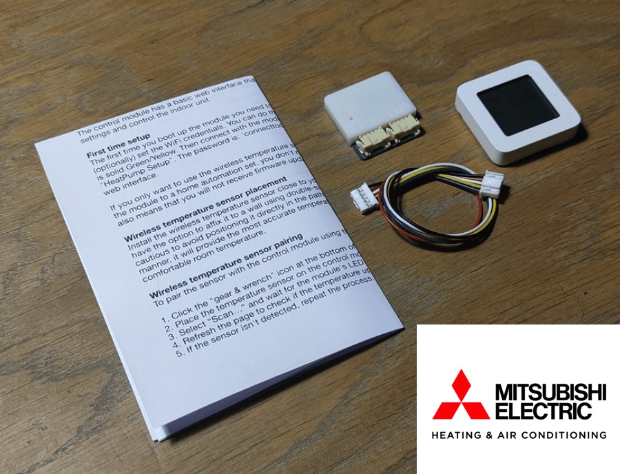

I found this solution on ebay. It replaces the Mitsibushi WiFi connector with a 3rd party solution that can then be managed via MQTT. If you don’t need the MItsi WiFi and Melcloud (which is now next to useless), this is a good local integration option.

I don’t know where you’re located but if you’re in the EU this might be a solution:
Module also support the use of the original MAC-IF adapter in parallel(you plug it into the second port on the climacontrol module) so you can use melcloud for remote control and connect the heatpump to MQTT. Pretty cool feature.
There is one module for Air-To-Water and another for Air-To-Air heat pumps.

There is also a DIY hardware/software solution to use the CN105 connector. See here:
The product page does not even have a link to documentation…
I understand the cable connects the white box to CN105 in the ecodan.
How does the box connect to Home Assistant?
Tx!
Module connects to the CN105 port with the cable you get supplied with it.
If you have a melcloud adapter already connected you plug that into the other port of the module.
It connects with Home Assistant(or any other home automation) over MQTT.
When you’ve setup MQTT credentials through the web interface, all the sensors, climate cards and switches appear automatically in Home Assistant.
Does not say what models are supported… ?
So far all Air-To-Water Ecodan/Zubadan models with a CN105 port appear to work.
Also all Air-To-Air models with CN105 work.
