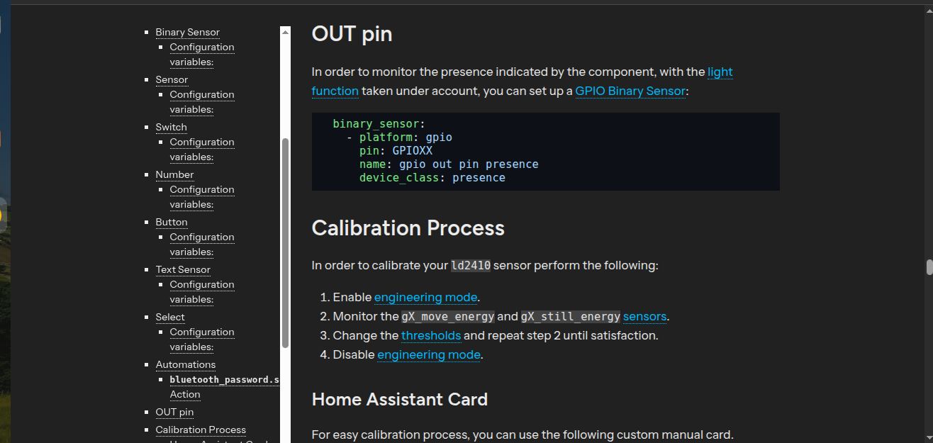

So, here are some basic configurations that you can find in the documentation for the ld210 sensor and each device or integration through Esphome will have all these configuration options listed in the documentation and these are the main building blocks you will need to use when creating your automations.

These additional configurations are used to calibrate the sensor or you could also say they’re for adjusting the sensitivity mainly. These sensors are so damn sensitive you can have a house fly sitting on a cabinet and it will continously trigger your mmwave sensor back to back and to prevent that from happening, you would use these and assign values to raise/lowet the sensitivity.

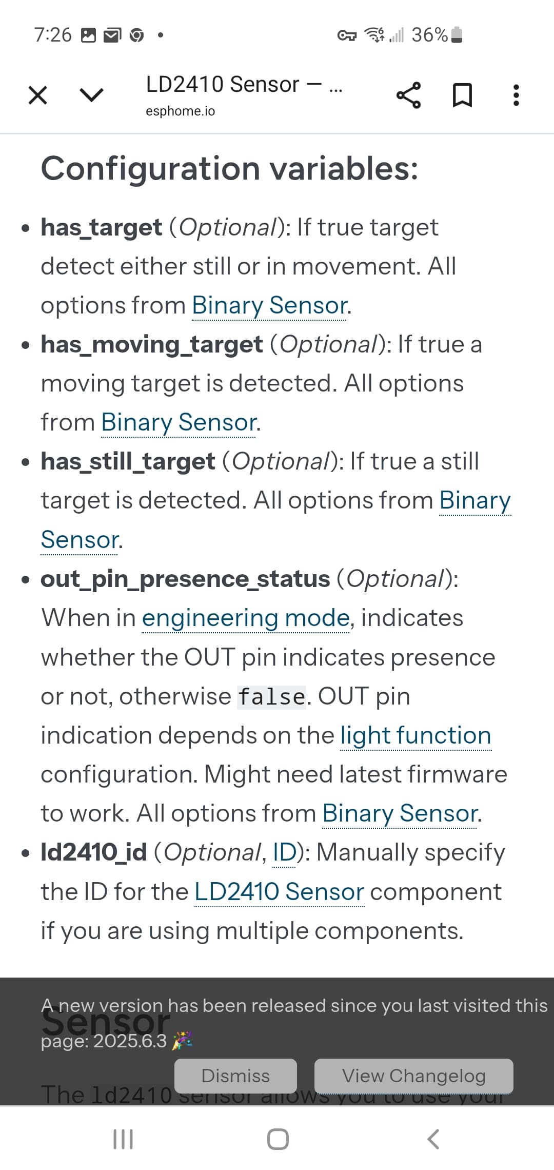

Once you do import those sensor states and the attributes for distance if you want that too but, You need to use those configuration options to incorporate that sensor data into your automations so, it’s kind of like ā€œputting the cart in front of the horseā€ if that makes sense but, again it’s all explained in the documentation like I keep saying but, there’s a reason I didn’t start with doing that.
I feel like a broken record but. i’m not sure the recommendation of reading the documentation is sinking in but, again here is the instructions for calibrating your sensor and setting how sensitive you want it to be and it also tells you how to incorporate all of that intio a singel binary_sensor output to show (Detected/Clear) to easily tell if there’s motion or not.
