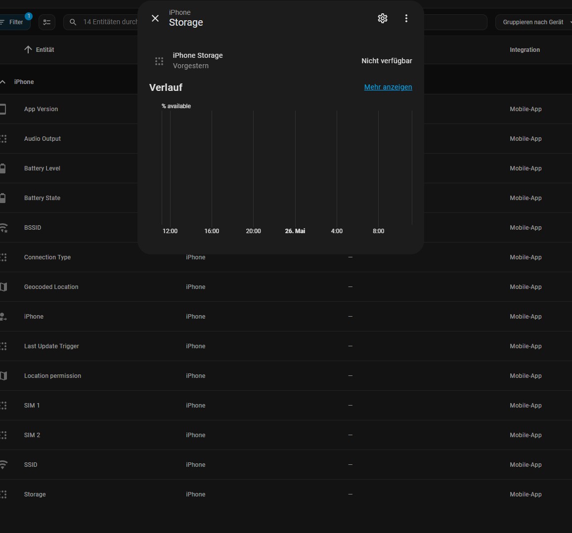

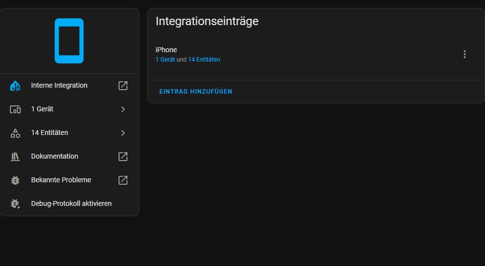

Do you know, how to activate this report, to see it in home assistant. With my old IPhone it worked without problems, with my new one I can’t see this entity and attributes in Home Assistant. Battery etc. works without problems.
It looks like this:

I have the same problem % available Storage“ in Home assistant is completely wrong. Do you have an idea now, for what it is?
