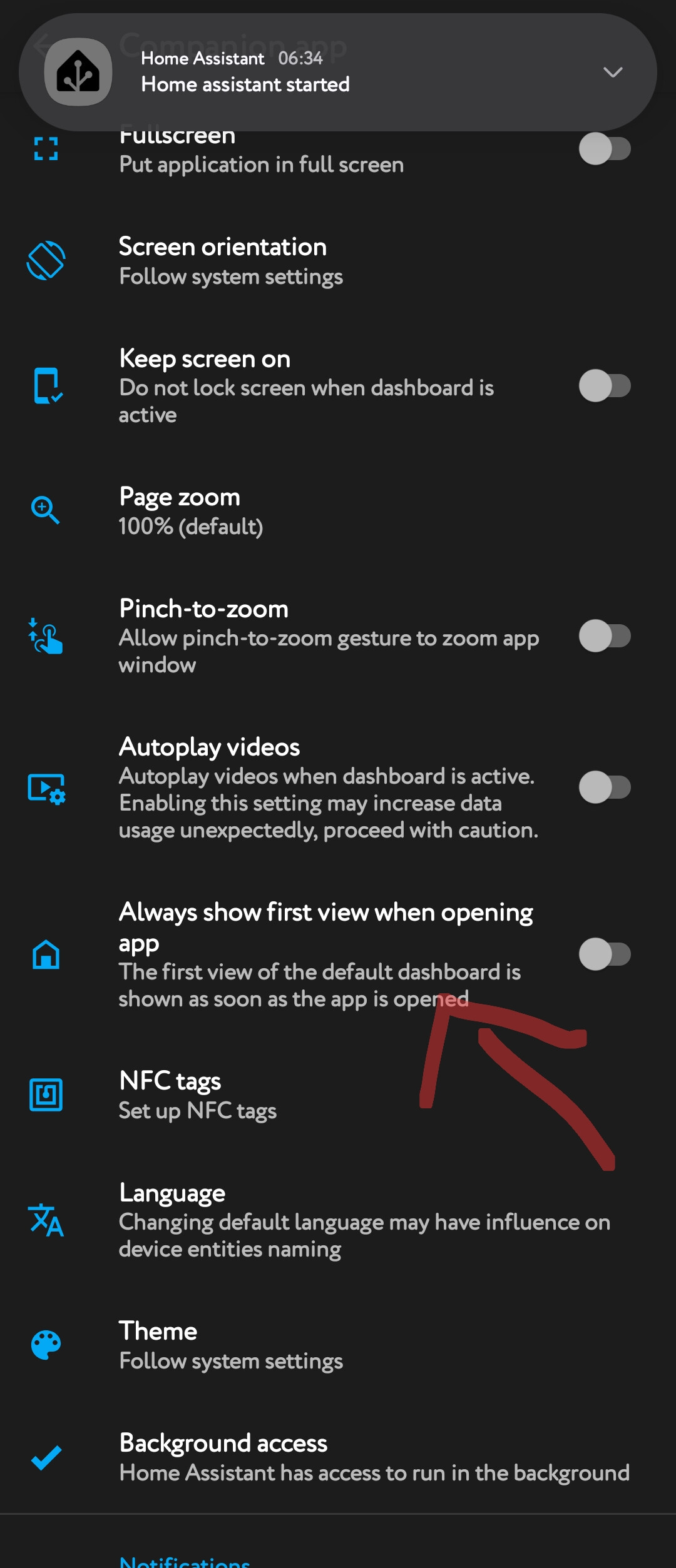

Hi all, I am not sure if this is a bug or it’s because I’ve configured my HA UI in a weird way (I don’t think so), yet if I swap to another app or hit home or otherwise leave the HA phone app, it always hops back to the main screen when I return. I would prefer it just remained where it was.
I have a home view with buttons to several subviews and some subviews under those. All are using the sections view. While I stay in the HA app on my Android phone navigation back and forth works fine, using the upper left subview return to previous arrow.
My issue is that any time I swap away from the HA app, it hops back to the home view every time. If there is way to either avoid or configure this behavior, it would make my day.
Any insights? Thank you.

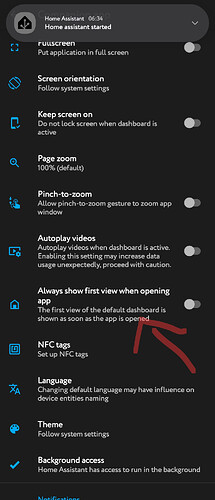

Don’t you have this setting turned on?
Yes I did - that was it, thank you!! :pray:
I may have missed this feature being added and set to on per default.
