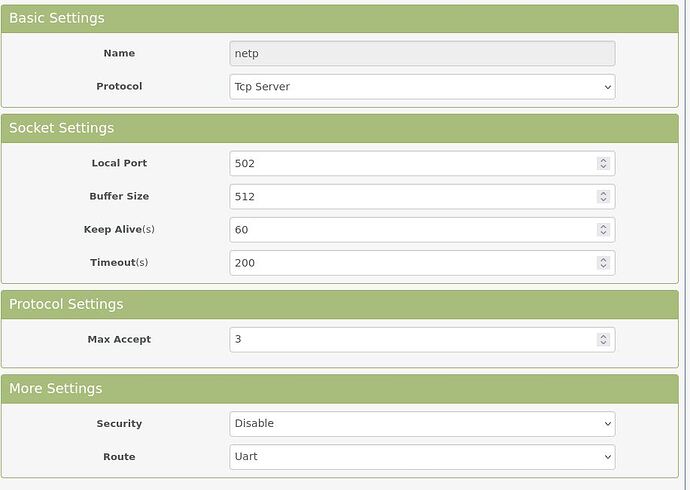

Elfin-EW11 Serial settings:
Elfin-EW11 Communication settings:

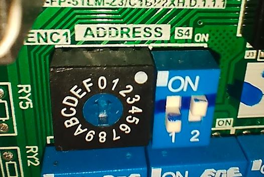

I managed to get communication I needed. For the settings in ew11 i changed port to 8899 and CLI to Serial string, +++, 300. These changes probably doesn’t mattered for my case. It turned out that my problem was a slave adress. On my device I changed default adress to something different. I chose address 16 following instructions from manual and also printed on electric box cover. Changed this with S4 dial. Arrow - 0, 1-down, 2-up.
s4
Turns out that manual is misleading and when i choose this address 16 it is really then an adress 17. I changed my code in HA to slave 17 and type: rtuovertcp to type: tcp and everything works now. Hope it helps.

the adressing looks like this, this is my case at least.
But a the same time when everything is set to be slave = 0 it responds to slave 64, so it might be this causing the shift from 16 to 17.

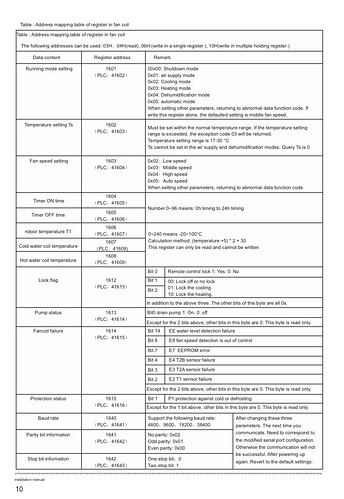

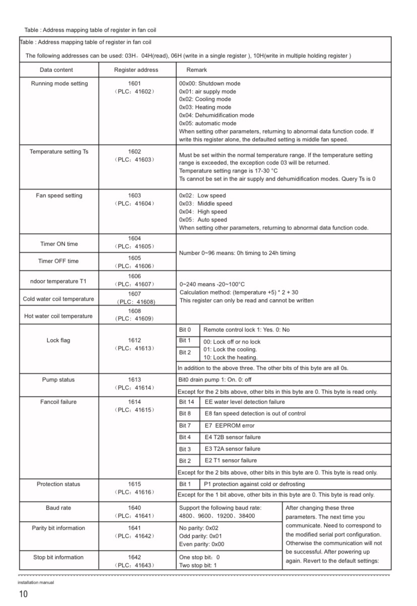

One piece I am still missing is the Modbus register specification. Maybe You could share it?
It should be this.

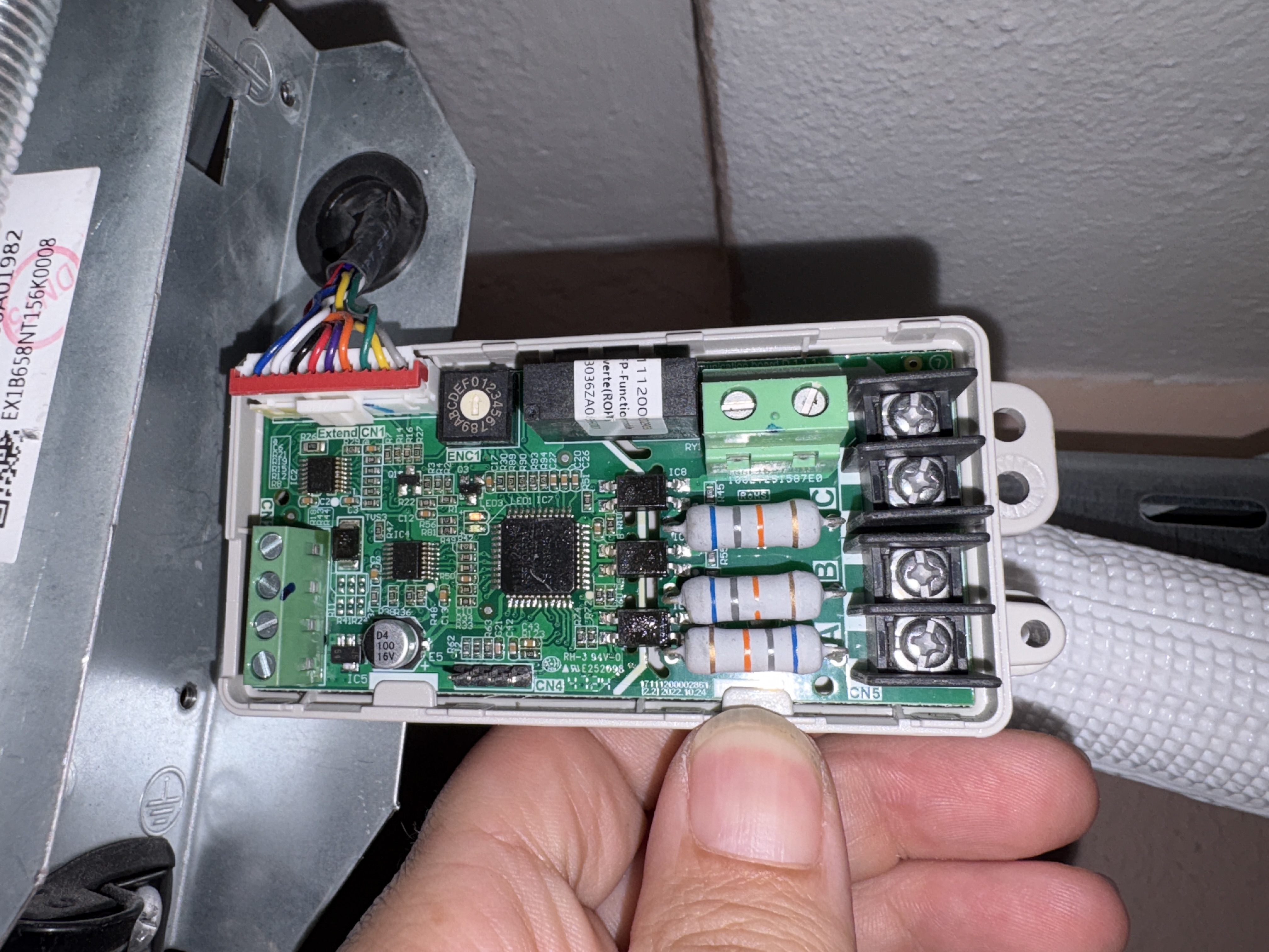

Hi. I need some help please. Read all forums and Gits trying to control my midea fan coil mkt3-600-cl which i purchased few weeks ago and hasn’t still been fully installed. I am trying with esp32 and max485 module or alternatively with atom lite and tail485.
The real problem is I need to narrow down my possible causes of not communicating by ensuring correctly wiring at first.
Can you please have a look at the photo of the extension board and help me?
There is the main board and then there is an Extension board which has the address dial switch on it. Main board has x1/x2 terminal for wired controller, pqe to upper unit and (D1)X,/(D2)Y to CCM. Thank you all.
