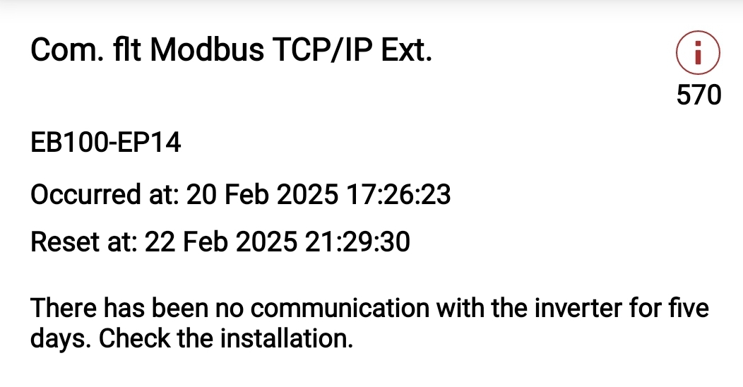

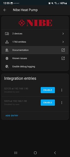

Good afternoon all! Has anyone ever had any issues with com errors after using the Nibe Heat Pump Modbus integration? See the attached image. When I disable the integrations for both the S325 and S2125
the error disappears.
Also is it correct that I add both my S325 and my S2125 via the same IP address and credentials or will this cause conflicts?
Many thanks in advance! :blush:

I wondered the same thing. But probably, you will get the exact same numbers for S325 and S2125 (but maybe a slightly different set of registers). After all, you connect to the same Modbus server (same IP, same port). So it makes no real sense for me to have 2 simultaneous connections. However, I still wonder what difference it makes to connect to the one or the other.
