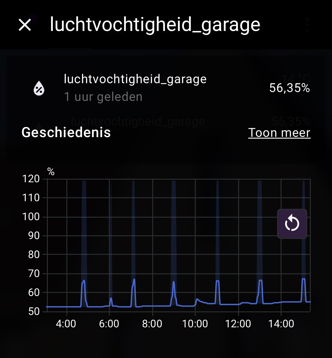

The only weird thing are those spikes in het humidity sensor.
