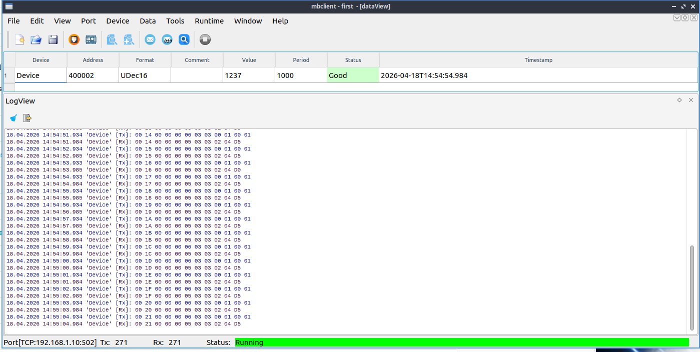

I am able to connect to the transfer switch and receive data using the ModbusTools program on my computer

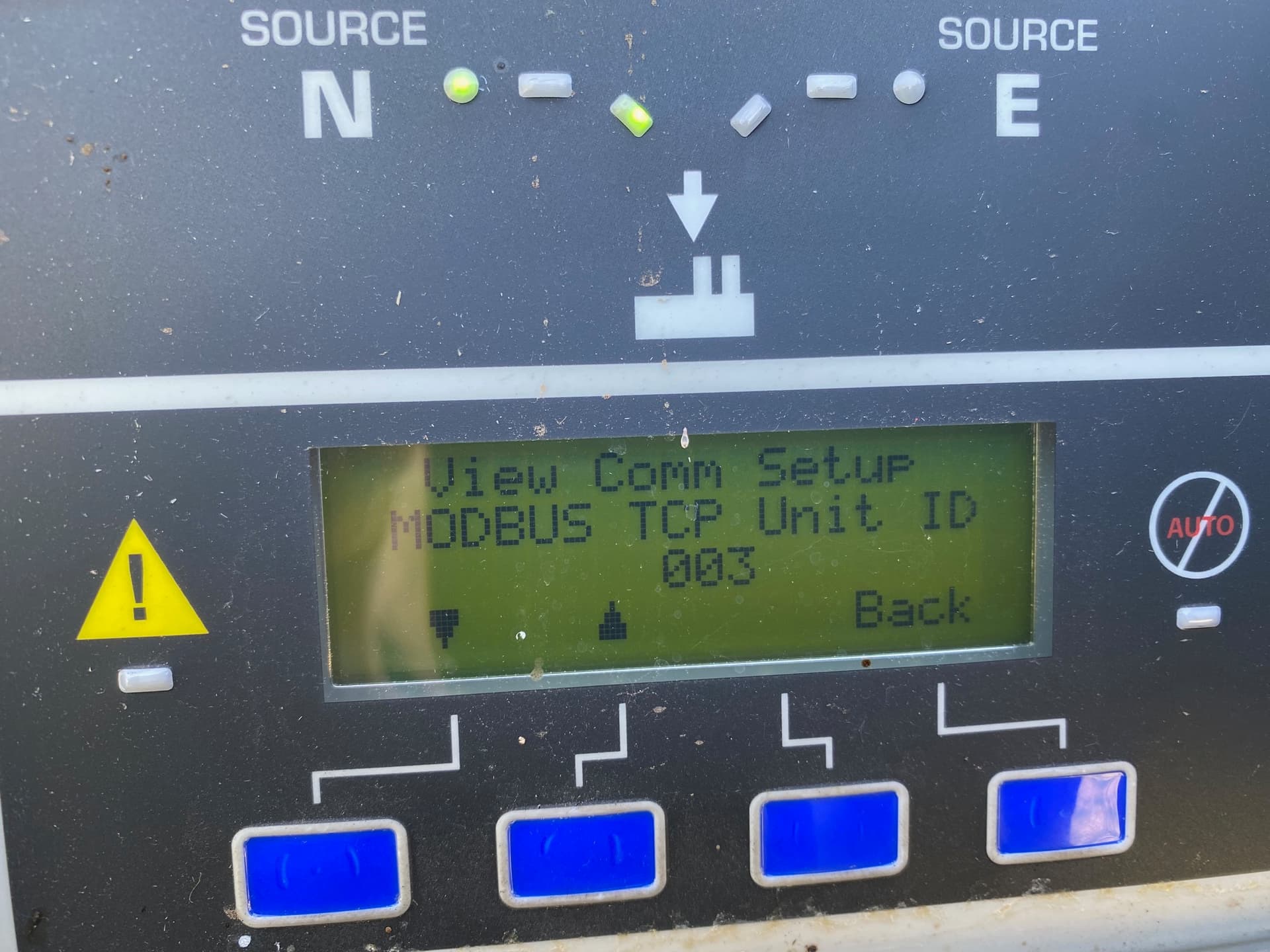

I had trouble getting connected with this as well until I edited the device and selected “3” for unit
my actual transfer switch shows this
I see no settings for this in homeassistant but then I have no idea if it is an issue. I see that what is being sent by modbustools is differrent than what is being sent by the homeassistant integration. I have no idea what I am doing so any help would be very much appreciated

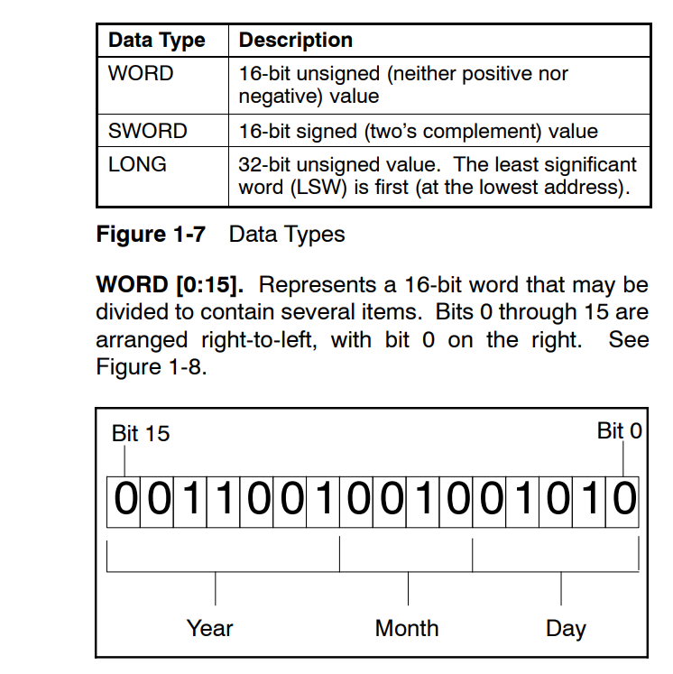

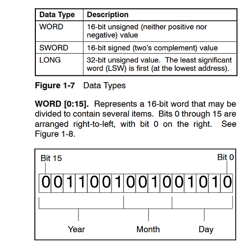

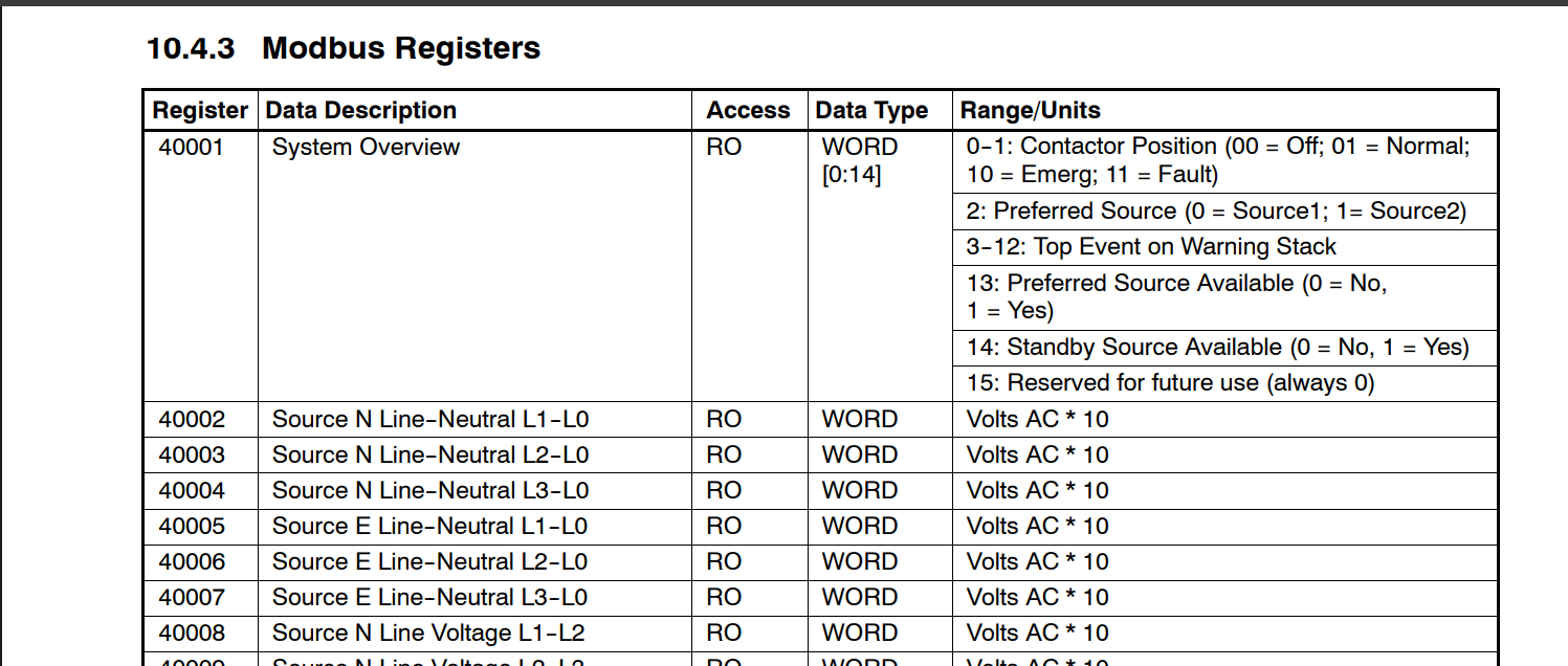

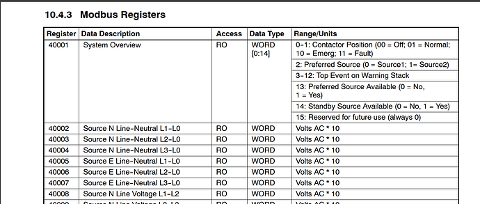

I am fairly certain that I should be able to read the register address of 40002, and that as it is “RO” the type would be input, although I have tried holding and auto as well.
40002 is data type WORD so UInt16 should be correct. also looking at that picture the bit order leads me to believe Byte Order = Big Endian and Word Order = Big (but I tried all configurations)

Ok, I am still unable to get the Modbus integration to work, but I did get it working using Protocol Wizard. The “no unit ID” in Modbus kept nagging at me so i did some research and found out that unit ID and Slave are the same thing. I tried to adjust my YAML to include slave but in the Modbus integration the slave variable is in the entity configuration part, this didnt seem to work even changing it to 3 like the unit ID on my transfer switch. Then I tried Protocol Wizard again and this has “Slave ID” ( * Slave ID (usually 1)) as you setup the device. as soon as I changed this to 3 i was up and running getting good reads. Not sure how it all correlates, but my device shows 40002 as the first register, I had to put 1 as the address so 40002 = 1, 40003 = 2, 40004 = 3 ect ect. so thank you partach
