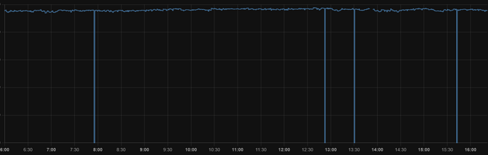

Modbus value if zero, present last know value - possible?
I would like to read some values from modbus device, but if there is no value or some communication disturbing device is sending “0”, and then my scope looks like:
How to make to skip read and use last know value if answer from device = “0” ?
