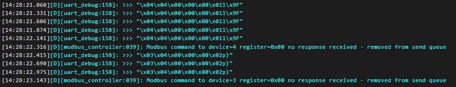

Hi, I’ve got a similar problem. Got a wind direction and speed sensor from Ali and could already change the address using the chinese tool to 3 and 4. When I try to include the example code to ESPHome I can see in the logs that the read command is 0x04 but the sensor doc says 0x03. Also in the logs above I can see 0x03. Is there a problem in the ESPHome Renke … sensor specification? or any chance to change this in the yaml?
Of course, just set
register_type: holding
I don’t know which one is correct though…
But you have some other problem as well, the uart debug data on your image is not valid modbus request.
