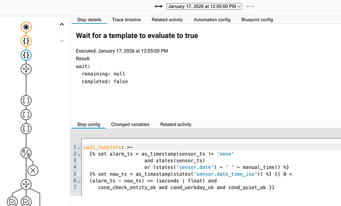

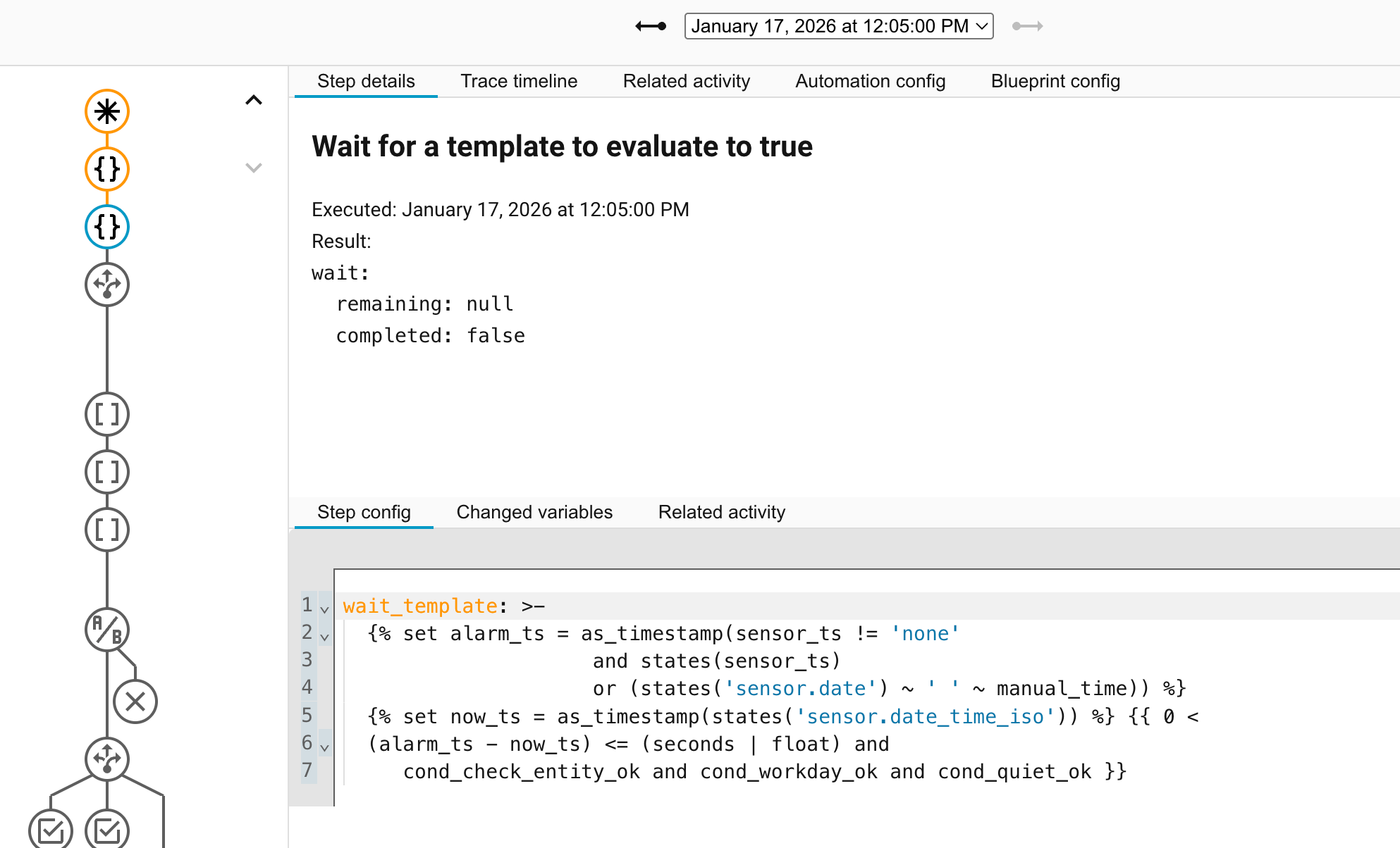

action:
  # 1) Auf gültige Alarmbasis warten (Timestamp vorhanden ODER manuelle Zeit)
  - wait_template: >-
      {{ sensor_ts == 'none' or as_timestamp(states(sensor_ts), None) != None }}
  # 2) Startfenster (0 < Alarm - jetzt <= Dauer) + Nebenbedingungen erfüllt
  - wait_template: >-
      {% set alarm_ts = as_timestamp(sensor_ts != 'none'

When I try to run the automation I get this error, I don’t understand what I’m doing wrong.
Error: In ‘template’ condition: ValueError: Template error: as_timestamp got invalid input ‘unknown’ when rendering template ‘{% set alarm_ts = as_timestamp(sensor_ts != ‘none’ and states(sensor_ts) or (states(‘sensor.date’) ~ ’ ’ ~ manual_time)) %} {% set now_ts = as_timestamp(states(‘sensor.date_time_iso’)) %} {{ 0 < (alarm_ts - now_ts) <= (seconds | float) and cond_check_entity_ok and cond_workday_ok and cond_quiet_ok }}’ but no default was specified
I have the same issue here.
*edit: Found the solution thanks to a video from simon42.
In the config.yaml you have to add the following sensors in order for the blueprint to work:
sensor:
  • platform: time_date
    display_options:
    • ‘date’
    • ‘date_time_iso’
Then after restarting HA it works perfectly for me.
