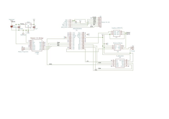

I don’t think it has been studied for dumb but expensive pool robots such as old maytronics dolphins, although the modification seems easier, due to the simplicity of the mechanics (3 motors : one for each side wheel, and one for the pump) and the associated electronics.
I already read on Arduino community boards that some guys replaced the electronic card with an Arduino with a temporisation between the motors to make it go forward then turn every x seconds only by switching on and off the wheels motors :
