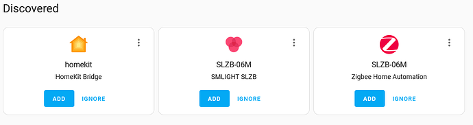

Here it says not in the configuration.yaml:
Do I need this two SLZB-06M integrations?
All my sensors and my Philips Tap Dial Switch just worked until now, so I did not add them.
Do I also need to change my other devices (sensors/switch) because of this deprecation?

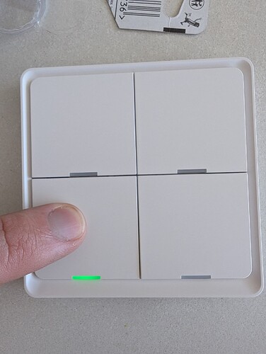

For anyone searching in the future, these are the buttons to hold for 10secs (more like 12-15 by my count) to enter pairing mode:
