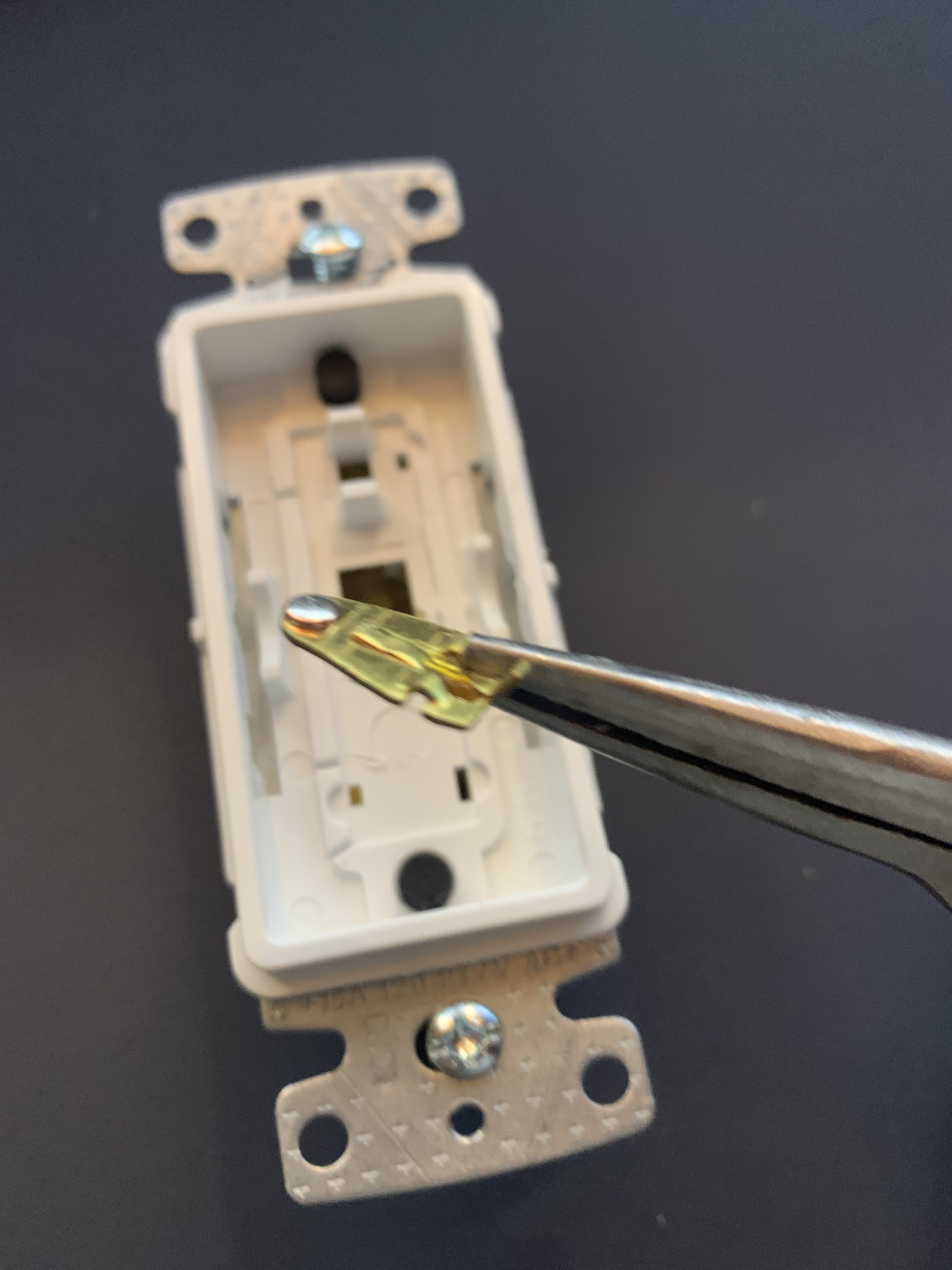

2 - Pull the contact out of the switch. Pay attention which is top for both the switch and the contact.
3 - Flatten the prong out on the top. Leave the bottom one as normal.
4 - Put the contact back in.

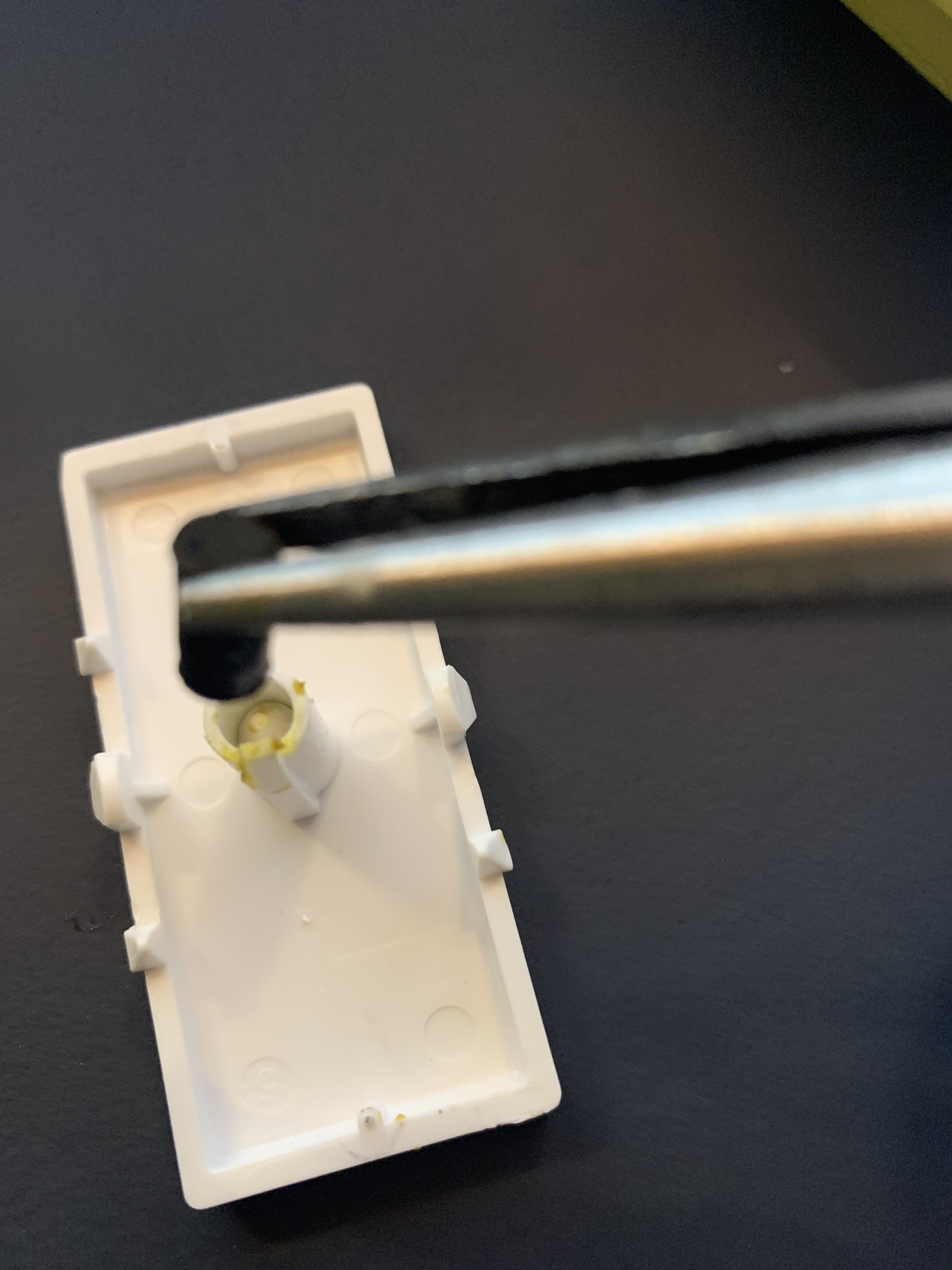

5 - Pull out the foam cylinder at the top of the switch.
6 - I don’t know what this is called, but pull it out of the rocker plate.
7 - Separate the plastic part from the spring and put it back in the hole, pointy side up.
8 - Push the foam cylinder into the the same hole on the rocker, over the plastic piece.
9 - Push the spring into the hole left when you removed the foam cylinder.
