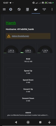

Hey Community, i want to share a Dashboard to Monitor docker Containers.
My Setup uses the monitor_docker integration.
monitor_docker integration configuration:
- name: Docker HassOS
  url: tcp://local-docker-socket-proxy:2375
  switchenabled: false
  monitored_conditions:
    - allinone
  scan_interval: 20
Dashboard: (using Auto-entities, Mushroom and more…)
type: custom:auto-entities
card:
  type: entities
filter:
  include:
    - entity_id: sensor.docker_hassos_*
      options:
        type: custom:stack-in-card
        mode: vertical
        cards:
          - type: markdown
            content: >-
              {% set addon_name = state_attr('this.entity_id', 'friendly_name')
              %} {% set addon_path = addon_name.replace('addon_','') %}
                {% if addon_path[8] == '_' %}
                  {% set addon_name = addon_path.replace(addon_path.split('_')[0] + '_','')  %}
                  {% set addon_name = addon_name.replace('_',' ') %}
                  {% set addon_name = addon_name.replace('-',' ') %}
                {% else %}
                  {% set addon_name = addon_name.replace('addon_core_','') %}
                  {% set addon_name = addon_name.replace('hassio_','') %}
                  {% set addon_name = addon_name.replace('addon_local_','') %}
                {% endif %}
                {% set addon_settings = "/hassio/addon/" + addon_path[:-1] + "/info" %}
                <div id ='{{ addon_name }}'><font color = {{'green' if is_state('this.entity_id', 'running') else 'red' if is_state('this.entity_id', 'exited') else 'orange'}}>
                # <u>{{ addon_name | capitalize }}</u></font></div>
                <h3>{% if states('this.entity_id') == "running" %}
                  Hostname: {{ addon_path }}
                {% endif %}</h3>
               {% if "hassio_" not in addon_path and not "homeassistant" in addon_path %}
                 [<ha-alert alert-type="warning">Addon Einstellungen</ha-alert>]({{ addon_settings }})
               {% endif %}
          - type: horizontal-stack
            cards:
              - type: custom:gauge-card
                title: CPU pro Kern
                entity: this.entity_id
                attribute: 1cpu_percentage
                measurement: "%"
                scale: 25px
                severity:
                  red: 50
                  green: 0
                  amber: 25
                title: CPU Gesamt
                attribute: cpu_percentage
                measurement: "%"
                scale: 25px
                severity:
                  red: 200
                  green: 0
                  amber: 100
                title: RAM (%)
                attribute: memory_percentage
                measurement: "%"
                scale: 25px
                severity:
                  red: 50
                  green: 0
                  amber: 25
            primary: RAM
            secondary: >
              {% set value = state_attr(config.entity, 'memory') %} {% if value
              is none %}
                {% set value = 0 %}
              {% endif %} {{ value }} MB
            tap_action:
              action: more-info
            hold_action:
              action: more-info
            layout: vertical
          - type: entities
            entities:
                primary: Speed Up
                secondary: >
                  {% set value = state_attr(config.entity, 'network_speed_up')
                  %} {% if value is none %}
                    {% set value = 0 %}
                tap_action:
                  action: more-info
                hold_action:
                  action: more-info
                layout: vertical
                primary: Speed Down
                secondary: >
                  {% set value = state_attr(config.entity, 'network_speed_down')
                    {% set value = 0 %}
                tap_action:
                  action: more-info
                hold_action:
                  action: more-info
                layout: vertical
                primary: Gesamt Up
                secondary: >
                  {% set value = state_attr(config.entity, 'network_total_up')
                    {% set value = 0 %}
                tap_action:
                  action: more-info
                hold_action:
                  action: more-info
                layout: vertical
                primary: Gesamt Down
                secondary: >
                  {% set value = state_attr(config.entity, 'network_total_down')
                    {% set value = 0 %}
                tap_action:
                  action: more-info
                hold_action:
                  action: more-info
                layout: vertical
          - type: entities
            entities:
                primary: Abbild
                secondary: "{{ state_attr(config.entity, 'image') }}"
                tap_action:
                  action: more-info
                hold_action:
                  action: more-info
                layout: vertical
                primary: Status
                secondary: "{{ state_attr(config.entity, 'status') }}"
                tap_action:
                  action: more-info
                hold_action:
                  action: more-info
                layout: vertical
  exclude:
    - name: Container*
    - name: Memory*
    - entity_id: sensor.docker_hassos_*cpu
    - entity_id: sensor.docker_hassos_images
    - entity_id: sensor.docker_hassos_version
sort:
  method: state
  reverse: true
Could you share a screenshot @seb5594
Here!
