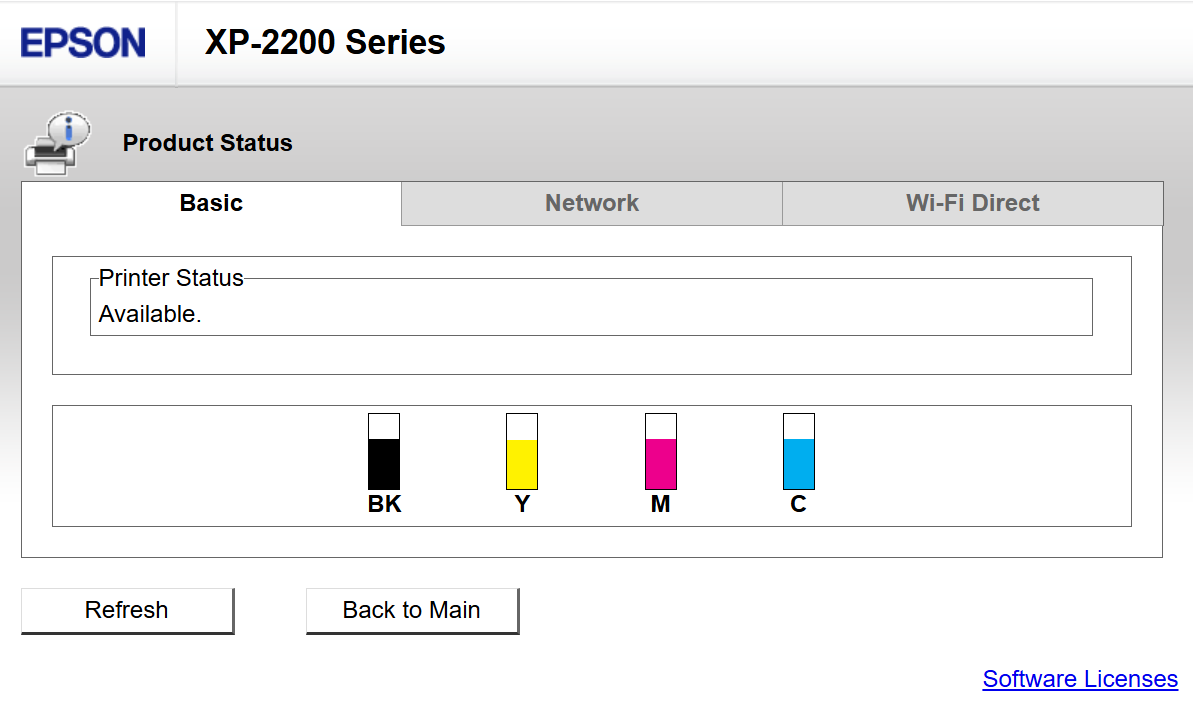

I try changing the colors as it shows on the screenshot:
  - platform: epsonworkforce
    host: 192.168.1.97
    monitored_conditions:
     - BK
     - C
     - M
     - Y
and it give me some error
