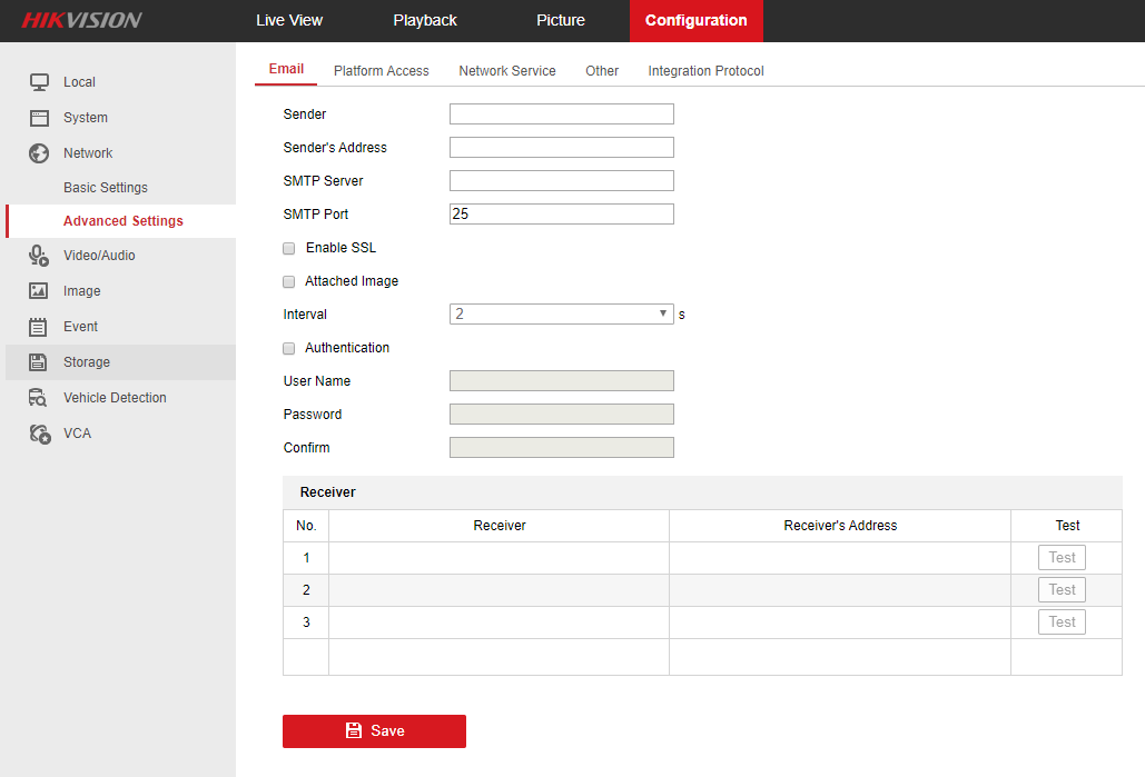

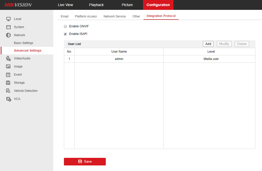

Here is screenshots from my NVR - menu should be same neverless of language…
I hope that this helps you…
This is what I have
BASIC SETTINGS
ADVANCED SETTINGS
Cannot find SNMP anywhere.
Go to NVR settings but not via web browser but directly plug in monitor via VGA or HDMI cable… then follow my steps…
Also be sure that you have the latest FW?
I have a DS-7208 too and SNMP is not enabled either on the web UI or native configuration menu. I am on the latest firmware. As per this document, SNMP is not available for DS-7208 model.
