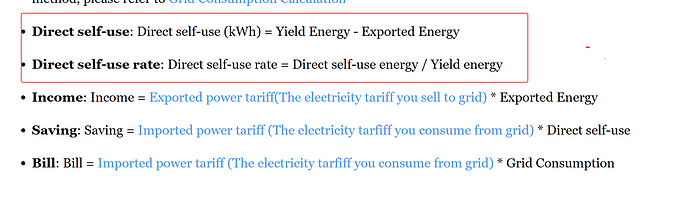

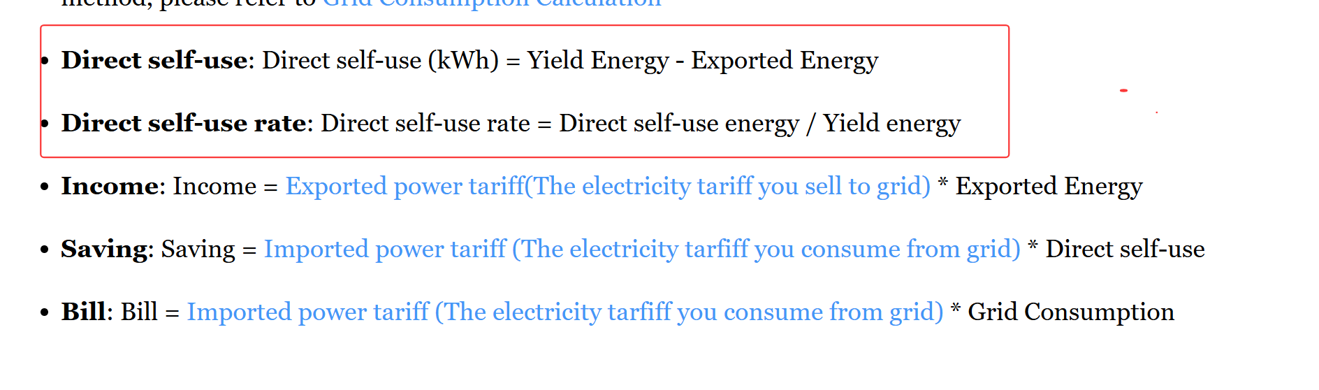

If I choose to install meters on both the grid and the inverter, can I obtain comprehensive parameters, including grid input and output power and energy, solar output power and energy, self-consumption rate, and other relevant indicators?
yes. The grid input and output, solar generation is monitor by meters directly , the self-consumption is calculated by such parameters above ,
The formula is like this Overview of Solar PV system monitoring
