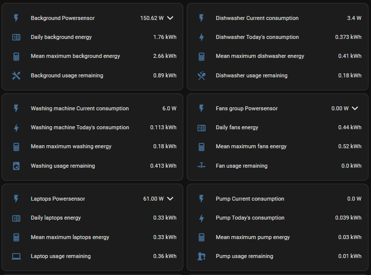

- Above is an extract from my HA, I have a total energy monitor at mains.
- I also have several smart switches for some devices, e.g. fridge, washing machine and PC
- This is because I assume the other appliances are using minimal power compared to the “heavy” ones
- I would like to know how much power these “other” appliances are using, in case someone connects something new/etc and it spikes up
- Has anyone done something similar?

The way I did it is by creating a sensor that simply takes energy consumption at meter and then substract the energy used by the individual appliances from that. Based on that percentage I started hunting for other energy consumers and either removing them from mains or started measuring them.
At this moment in time I measure about 90% of all my energy consumption. See charts below:
Absolutely. I also have a whole bunch of usage remaining templates that calculate the average use vs the current use:
