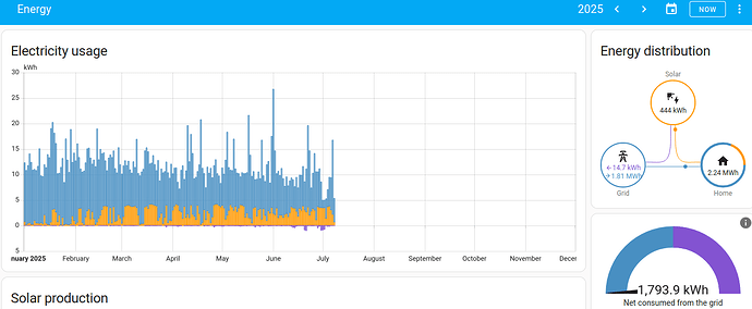

it was like that in the past: in yearly view of energy dashboard I had bars for each month. This changed to a more fine grained visualization with one or the other HA update, I don’t remember anymore. How can I get the old behavior back?

I’ve already tried deleting browser cache, using private window and so on, when I recognized this. Did not help. It’s like that a couple of months now and I hoped it corrects itself. Sometimes it takes a while to recalculate it I thought. There must be more people having this issue.
I took me time today and finally found the cause: it’s in the user settings: timezone local vs server. I changed it from server to local and now it works. strange behavior

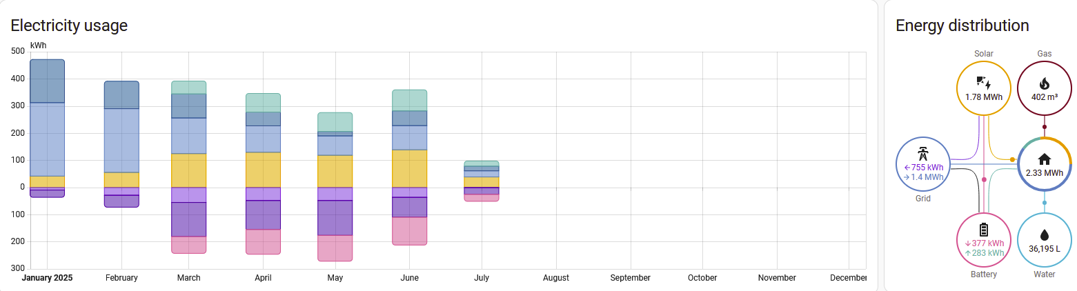

I got it nicely per month. Running 2025.7.1 on Docker.
