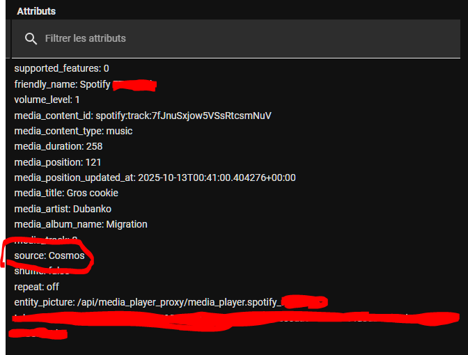

Why don’t you use the Spotify integration?
Linked to your account, you can see on what device spotify is playing.
I used to use it like this:

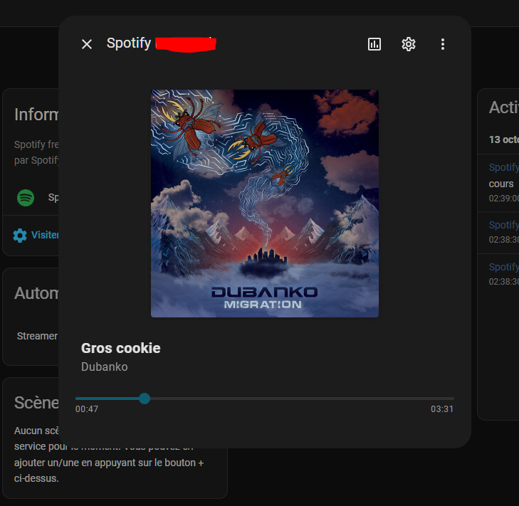

When spotify plays on “Streamer” (my moode’s name), then turn on my amp, and make a small lovelace card visible showing that “Streamer” is playing from spotify.
With some custom cards, you even can “integrate” what i did (show “Streamer playing”) in the same card where you display MPD’s info.
From the Spotify integration, you even get the cover and metadatas:
Here are the states:
The source “Cosmos” is actually my smartphone.
