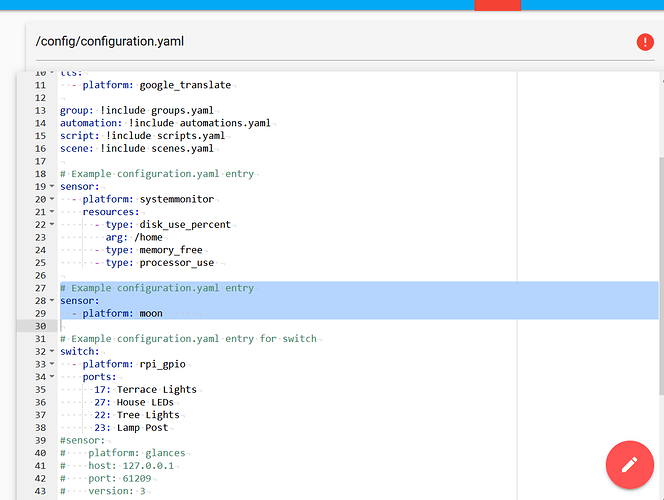

Hi all. I think I am going mad. All I want to do is add the following to my configuration.yaml file using the editor.
Example configuration.yaml entry
sensor:
  • platform: moon
However when I do this using the file editor it gives me the warning red (!) in the rh corner.
what am I doing wrong?
Using HassOS 4.12 and latest updates.
Take out the second sensor: line
not sure i understand your suggestion.
In your file you have 2 lines that say sensor:, Take the second one out. You are only allowed one.
oh i see. thanks. that worked. i was being daft. cheers…j
