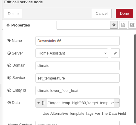

Coming from Smartthings, I heavily used modes as well. To carry that over, I created an “Input Select”, Input Select - Home Assistant with defined modes of Away, Home, and Night. My Node Red automations heavily use these modes, as both conditions and triggers. Other automations change and set those modes based on presence, time of day, etc.
You would do a call service node, and in the data field, choose the {} for JSON in the drop down, and then convert the YAML required by the call service to JSON. The key with Node red is it uses JSON, while Home Assistant uses YAML. You can use a YAML to JSON converter like this - Transform YAML into JSON - Online YAML Tools and it would look like this:
    "target_temp_high": 80,
    "target_temp_low": 66,
    "hvac_mode": "heat"
Screenshot from 2022-05-03 12-20-24
