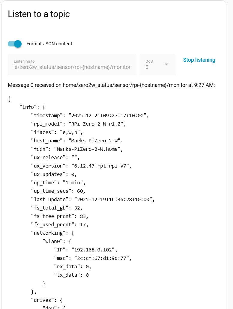

MQTT Explorer identified the issue as being the topic.
I had “home/zero2w_status” but the topic as built in the Pi System Monitor code is “home/zero2w_status/sensor/rpi-{hostname}/monitor”.
This makes sense as I could have multiple Pis transmitting data and the topic would need to be differentiated.

So I can see the data for this the topic ok in MQTT Explorer and Mosquito MQTT/Setting/Listen to a topic no problem.

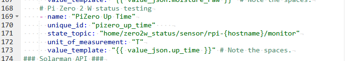

I added a sensor in the configuration.yml for “up_time” but can’t get a value.
I feel I have some basic error in the config file but I can’t see it.

As suspected the issue was me not understanding the sections with the json string.
Info section:
○ Up_time_secs = value_json.info.up_time_secs
○ Temperature_c = value_json.info.temperature_c
Networking section:
○ IP = value_json.info.networking.wlan0.IP
Drives section:
○ Size_gb = value_json.info.drives.root.size_gb
Memory section:
○ Free_mb = value_json.info.memory.free_mb | int where “| int” defines the value as an integer.
