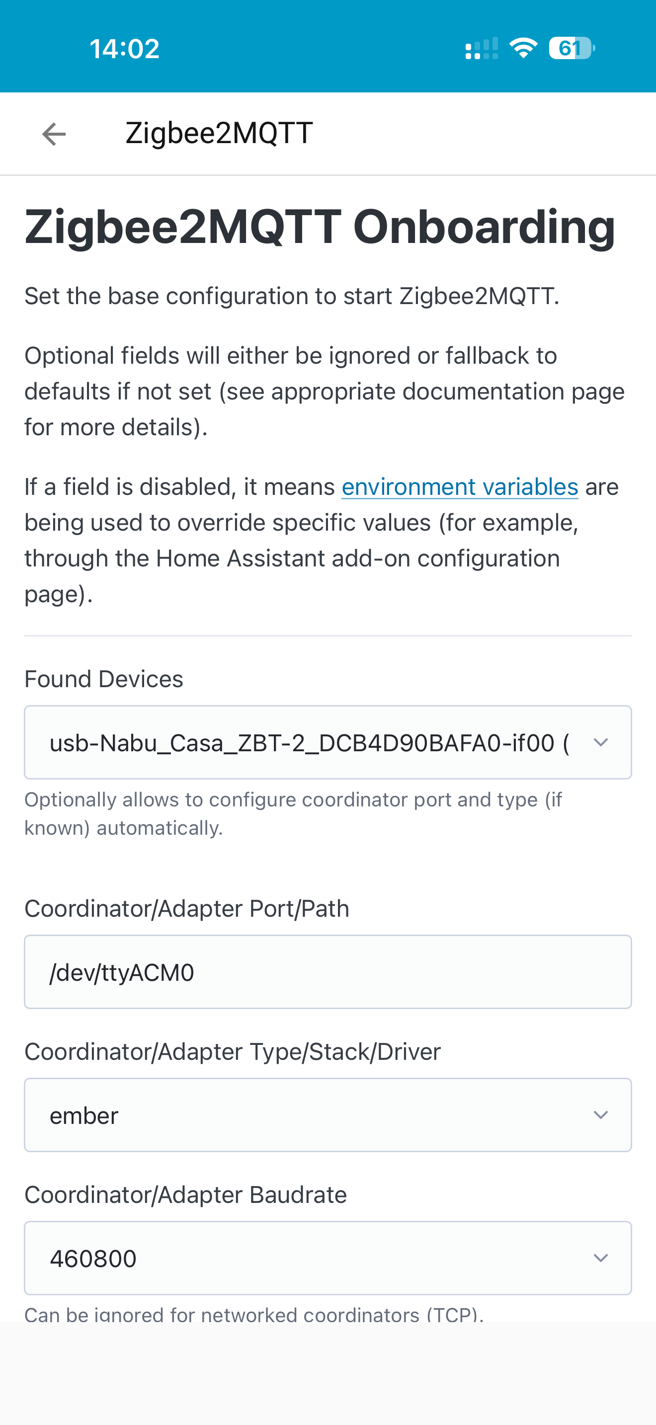

I have changed the serial and port settings, et cetera in the add-ons configuration, but Zigbee2MQTT will not start.
Is there anything I can do, or is completely burning my entire Zigbee network and having to rebuild all my automations et cetera from scratch the only option?
Edit - it’s seems Z2mqtt doesn’t want to work with the ZBT-2 at all, even after a complete removal and reinstall of the Z2mqtt addon. It just goes back to the onboarding screen.
